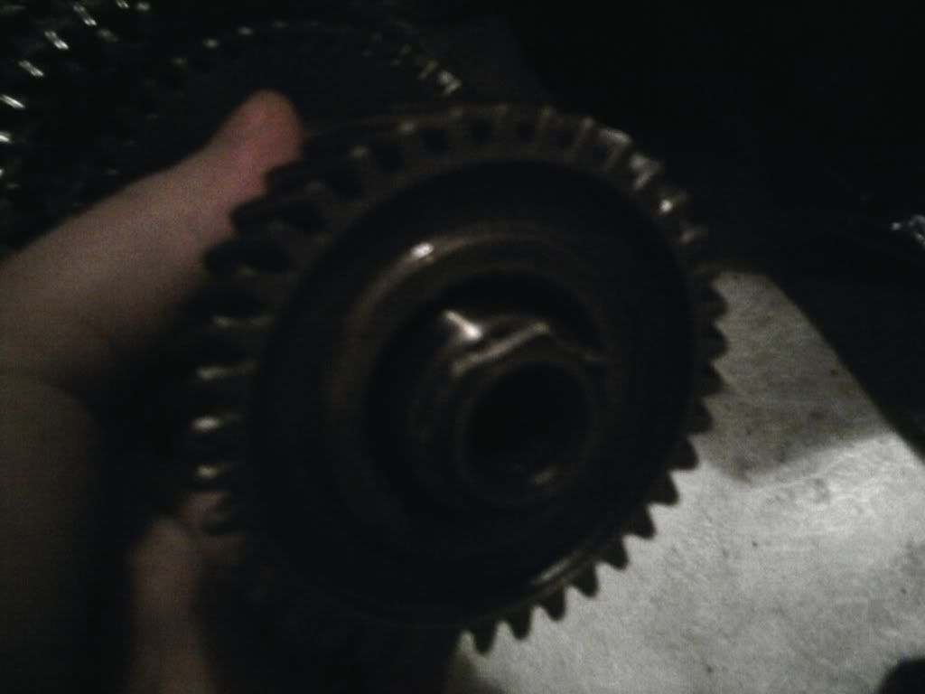

Just want to get it together the cheapest route. It is a bearing retainer on the output shaft. There are two other parts, but I can get them. I called my local gm dealer and he said not one dealer in the county had the one piece I cannot find. Together I'll have roughly 200 into parts, and still need that last piece, which shouldn't be too expensive if found.

bearing retainer on the output shaft, I'm having trouble picturing the part. Is it part of the input shaft bearing seal? Or the throwout bearing? Well as long as the transmission is still good mainly 2nd gear the ya that's not bad as I bought the 86 trans, cables and mounts for $250.

It is the 2nd number 24 http://www.gmpartseast.com/...204-l44m192pg97.html

damn, ya that end piece.... Is it just a threaded low profile head bolt that seals the end of the shaft? See if you can find a cheap junkyard trans and tear the part out of it, unless they are one time use. Otherwise ya go with the 5 speed

A cheap trans is what I need. I believe it is removable. It has splines on the inside to remove it.
The piece on the end is it, mine is obviously broken.
