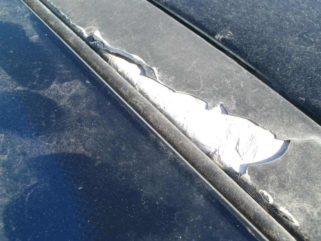

I would like to do some body work on my '85 SE. The roof panel (the panel that has the sun roof) is flaking and has one area where the fiberglass is exposed:
http://i154.photobucket.com...ome_red/PC290356.jpg
http://i154.photobucket.com...e_red/PC290355-1.jpg
How do I fill this area? Is this where I would use the Fibreglass Evercoat 870 Vette Panel Adhesive/Filler that I've heard about? Or is there a lower cost alternative (I can't imagine how I would ever use an entire quart of that stuff).

The hood, roof, and decklid are SMC, so yes those are what you want to use the Vette panel adhesive on and SMC resin if your fiberglassing

The roof, hood, and decklid are all SMC, this would work on all 3:
https://www.fiero.nl/forum/Forum2/HTML/103013.html

Where the finish is chipping away on the roof--do I just sand/grind that back to where it's still solid?

Always grind the area where you're filling with a 24 grit disc - yes back to solid material.
EDIT: You'll want to pull the windshield trim out as well as the sunroof rubber. If the trim breaks the Fiero Store has factory-looking replacements. Don't put it back on until after the roof is painted.
