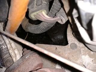

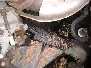

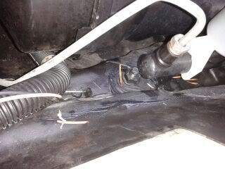

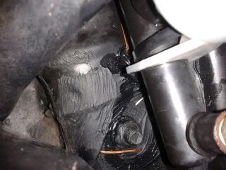

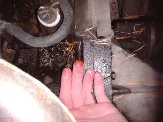

Ok, now that I am on my laptop, here are some pics of possible leaking, I had sprayed my car off and saw this, but I waited 2 days and checked again and it's still there. The liquid is also on the underside of the master.
Then I went back to check the slave cylinder and saw this
I started brushing all the pine needles off of it and this was the color of that gunk on there
And in between this spot it was there too
So I think the master is leaking, but it's the back leak that concerns me more, since its a huge spot and I'm not 100% sure what it is. I seemed too far away from the slave cylinder.
[This message has been edited by FireGirl (edited 01-02-2012).]

when hydraulic fluid leaks, it likes to make a much larger spot than oil or water that you are used to.
edit: what I mean is, one drop of brake/clutch fluid will spread out to about 5x the size of a water drop on a flat surface.
