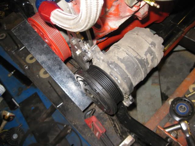

Use a metal straight edge on the crank pulley to check alignment of the belt other driven item pulleys (alternator) and the idler pulley. Belt misalignment will eat belts up in short order and cause the belt on the crank pulley to slip a notch in the direction of misalignment.

I prefer to bolt a piece of angle to the balancer and either use stacked up washers for a pointer to the first groove peak or use a tape measure. Here are some pics (but not 3800 specific).
