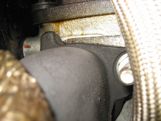

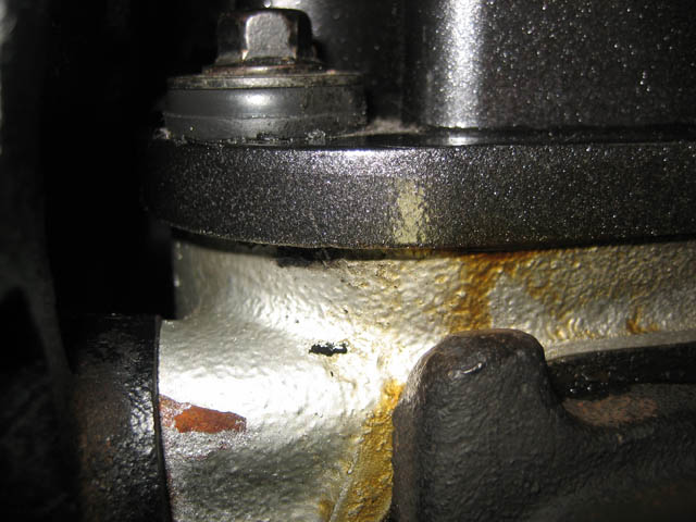

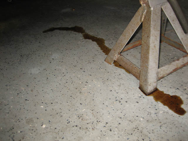

It started very slow. I even drove 1600 miles thru RFTH and leak didn't reach the floor (for me to notice). Then in the next maybe 200 miles I saw a drop at the floor. Looked closely and seems like valve cover as it was wet at the bottom. Cleaned everything, drove again and there were other drops that run down the block then to the top of compressor and then the floor. Then I had the car parked working on the A/C manifold hose. Nothing touched in the engine. Overnight I had this mess
This is happening at both, front and back. I used new plain ZZP VC gaskets and didn't overtight anything. So is there any trick to avoid this mess? I can't drive this thing like this

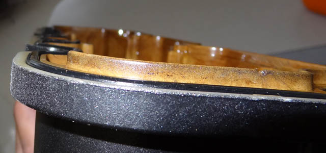

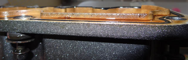

I think I got crappy gaskets. Look at this.
Here it is where it is leaking. The gasket went flat.
This is the other side which kept the shape to seal.

It's imperative that you also replace the grommets that are underneath the valve cover fasteners. Replacing only the gasket isn't enough.
I can see defects in that gasket. Get a blue permetex set.

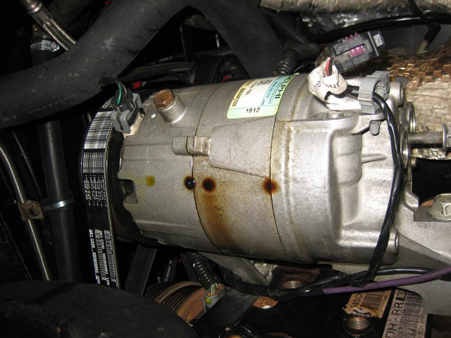

On a side note you need to plug you AC comepressor/add the lines or it will be trashed from driving with it exposed.....That is it is not all ready trashed from road trash getting in it..
Thanks but that has been covered all the time. I was just going to install the new A/C hose when I got into this. Much easier to work there without it. Hopefully once done with that I can finish my A/C system.

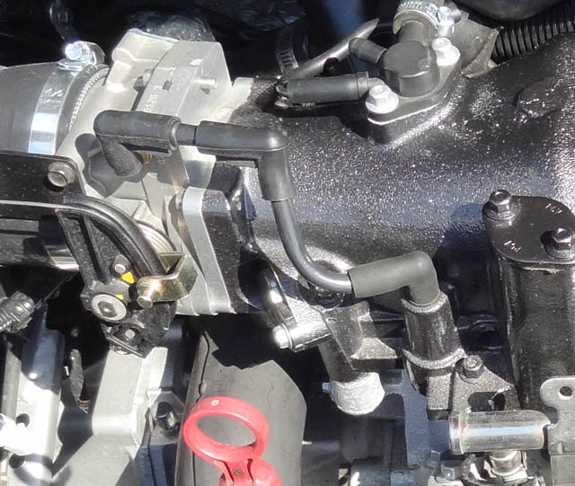

So where exactly is the PCV? This is how I have this hooked up. Is it wrong? Tks

you pvc is under there.
