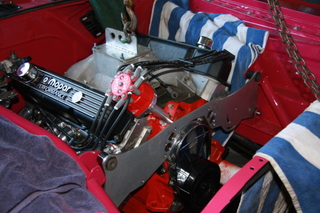

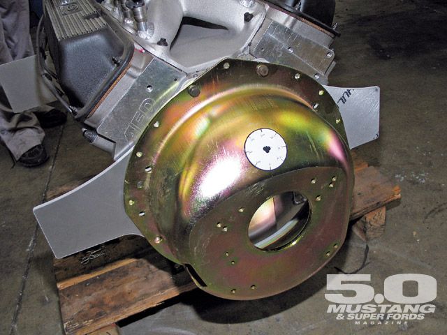

This is what I'll use for the 4.3 install.
For front, but with ACC's mounted, and motor mounted to cradle through the two ends of the plate
Same for rear, but will serve AS adapter, AND two motor mounts same as front.
As for the single rear trany mount. I see what your talking about, The front of the tranny will be supported by the rear plate, and if I need to use two rear mounts as well, I'll do that. All mounts will be polly(it is a daily)

With the FWD tranny attached to the 4.3, the Mount/adapter plate will only be able to be attached to the front cradle crossmember, as the auto trans extends along the side of the block on the trunk side of the engine.
The two transmission mounts will suffice to anchor that end of the drivetrain to the cradle. Do yourself a favor and don't overcomplicate your install.
