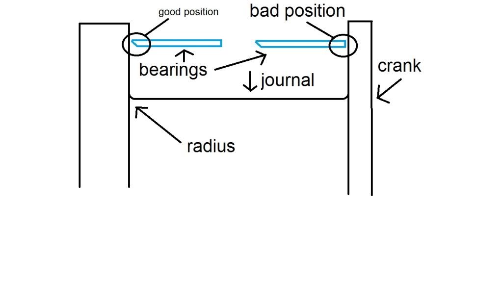

Sounds to me like you installed a connecting rod or two wrong. if you install them flipped 180* it puts the chamfered edges of the rod bearings facing each other ( respectively the two rods that share the same journal). the chamfers of the rod bearings need to face opposit each other on the rods that share a journal. I did this on my V8 built and tried turn turn it by hand and was like WTF ! found my mistake. The rods are notched for the bearing tab,if the rod is installed on the piston wrong it'll be backwards basically.i'll see if i can get a pic of some 3800 rods and bearing tomorrow, that'll explain it better.
Drew this up real quick on paint hope it helps.
When its installed in the bad position the bearing pinches the radius on the crank journal causing it to be hard to rotate.
12.3 is faster than a 13.2
[This message has been edited by FIEROPHREK (edited 10-05-2011).]

Good thought, FIEROPHREK - that's an easy mistake to make and not an easy one to find when you're looking for the problem.

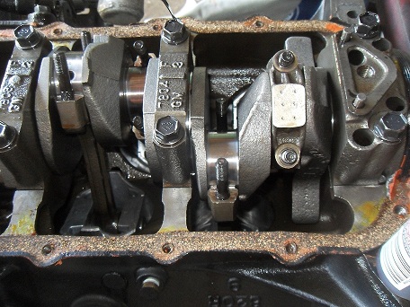

ok, I took the caps off and the pistons have room to wiggle, the bearings are standard size, not oversized, the crankshaft is a remanufactured one, and here are two pictures showing how the caps went on. the left of the photos are the front of the block and the right is the back of the block.
I dont know what to do, all the rods look like they were installed correctly (unless they were all installed backwards)
and the caps also match to the piston connecting rods.

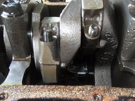

Report this Post10-12-2011 03:01 PM Click Here to See the Profile for AL87Send a Private Message to AL87Direct Link to This Post
AL87
2578 posts
Member since Mar 2010
in picture number two the square ends of the caps both pointed to the back of the engine, I turned caps 1,3, and 5 around so the square ends face the front and it seems that all the pistons have some wiggle to them after being torqued to spec.
