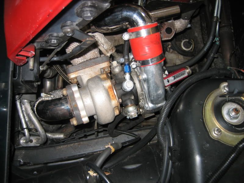

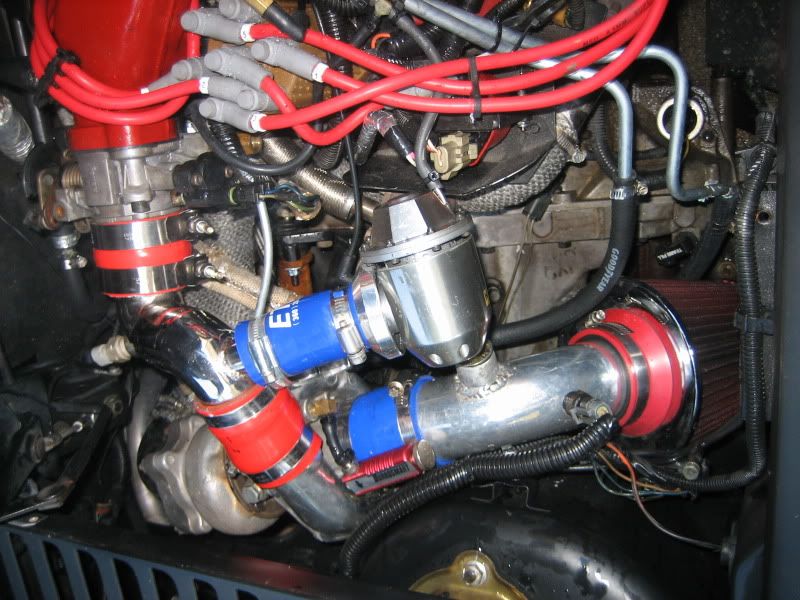

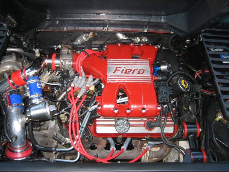

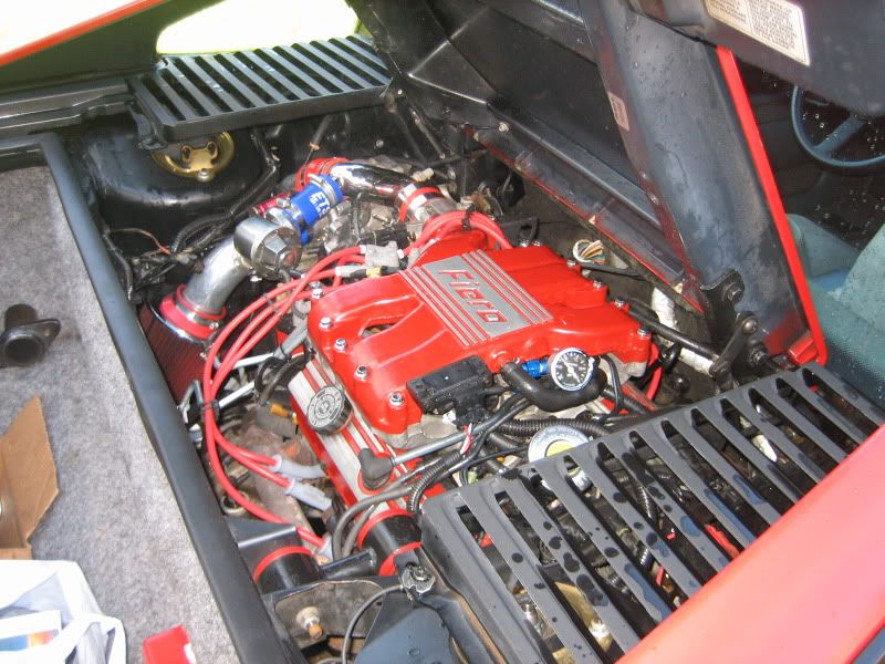

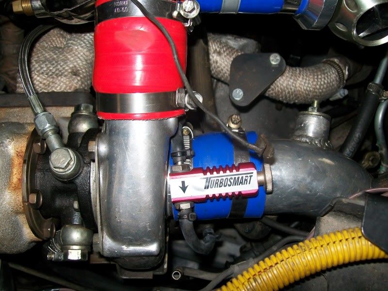

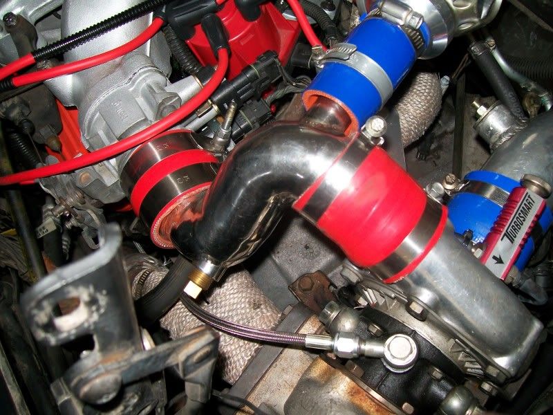

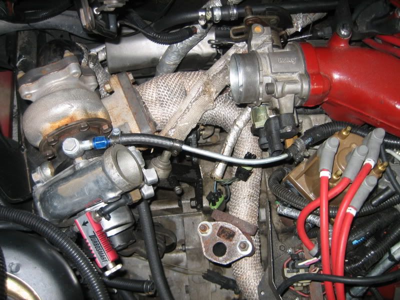

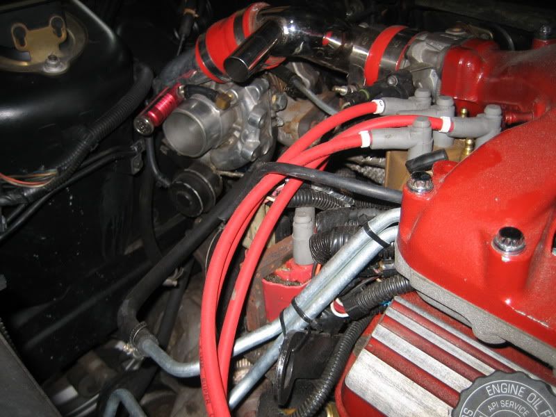

I've already removed the vacuum hose that controls the waste gate actuator, and it made no difference. The gauge i'm using is actually a vacuum gauge but it reads up to 15 positive psi. It's connect to the EGR nipple by the throttle body.
here's some pictures...
All of the above are from the previous setup. Everything below is from mine. Mine looked just like the previous setup, but I didn't have any of my own pictures and it's currently disassembled

Have you actually verified the wastegate is closed? I don't mean just checking the wastegate actuator. I mean removing the C clip and physiclly pulling the actuator arm loose from the wastegate itself. If that actuator arm is adjusted too long it will hold the wastegate open at all times. You can use a strong spring to hold the wastegate closed as it will be pushed open without something to hold it closed.

That looks pretty solid to me. If you are sure there is no air escaping prematurely from the blow off valve there are two things left, the actuated wastegate and the turbo. If you are sure without a doubt that the wastegate is closed and is staying closed, the problem may very well be the turbo given the unusual noise you stated you are hearing. Not having a clue as to what the noise you are hearing sounds like, it could also be the sound of escaping air. None the less even in that scenario if the turbo was functioning properly you would notice some improvement in acceleration. If you loosen and adjust the compressor housing with the wastegate in place it will affect its adjustment.

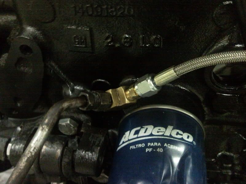

What if the turbo wasn't getting enough oil? Because when i tried to remove the oil filter after installing the engine it actually collapsed a little.. I think you can see it in the picture.
Joseph Upson
Posts: 4951
Total ratings: 88
Report this Post10-04-2011 06:23 AM Click Here to See the Profile for Joseph UpsonSend a Private Message to Joseph UpsonDirect Link to This Post
If the turbo is not getting enough oil and there is no restrictor in place, the engine would not be getting enough oil either. As Hudini has pointed out also, you need to be sure the wastegate is closed and in order to do that you'll need to disconnect the wastegate actuator and check to see that its connecting rod actually retracts indicating that it is holding the wastegate closed under its static spring pressure.
To do this accurately the turbo must be in the same clocked position that it is right now on the car. If you disconnect that rod and it doesn't move inward toward the actuator and you are able to move the wastegate door of the turbo further inward toward what would be the closed position, then you have likely found the problem.
You can also remove the filter tubing and watch the compressor wheel while revving the engine some to see if it is spinning consistently with engine rpm. It may move a little to not at all at idle but should spin quickly with elevated rpm. Becareful not to have anything loose in the area that can be sucked into it.
You should also put your hand over the compressor outlet and rev the engine to see if it builds a significant amount of pressure to suggest it has the potential of moving enough air to keep up with or exceed the engine requirements. It should be more impressive than what you'd experience if you put your hand near the exhaust vent of a vacuum cleaner.
