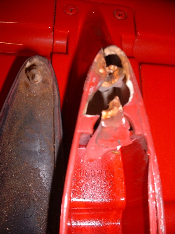

It's a little out of focus, but here's what a customer's OEM wingstand looked like when he brought it to me:

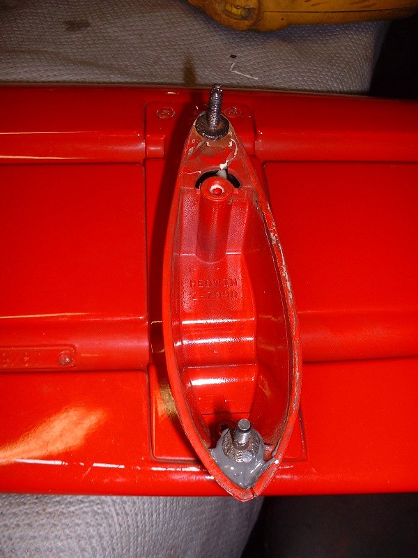

I did as you've already suggested, roughened up the inside of the stand, and filled it with two part epoxy. Rather than drill and tap the new holes though, I put a thin amount of vaseline on the threads of the screws and then dipped them in the epoxy making sure it got well into the threads of the screw before finally sinking the screw into the wingstand. Basically casting the threads instead of tapping them... same diff. It worked well. Here's a pic part way through the process:

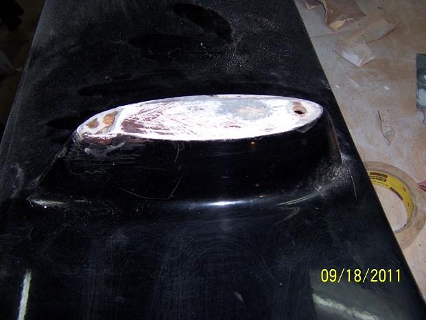

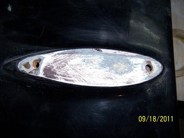

Maybe I should have posted these first; there’s no way to get to the back side of the holes....without making another one
the fiberglass thickness is about 1/2" and as you can see it needs a little work anyway. Maybe doing both will be best, fill with epoxy AND glass on a few layers. I'd rather not use larger studs as I'd have to drill larger holes in the deck lid. Unless i can find some studs with larger threads on one end only...hmmmm. Mabe do all 3?
