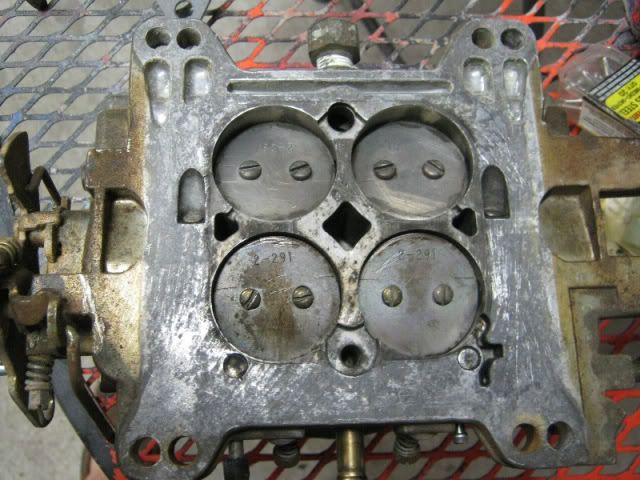

the issue isnt really the mounting. that part is kinda idiot proof. its that the 4 bbl has a set of ports in the middle of the bottom side and idk waht they are for or if the fact that the adapter is open (no sealing surface in the middle) if this may effect the operation of the carbs and how i should go about mounting them. and also i need some ideas on how people mount their cables and such

Set of ports in the middle of the bottom, not sure what you mean
Maybe a pic would help. Since you say there's no sealing surface in the middle I assume you mean between the primary and secondary throttle plates? This is normal, they do not need to be separated from each other below the carb.

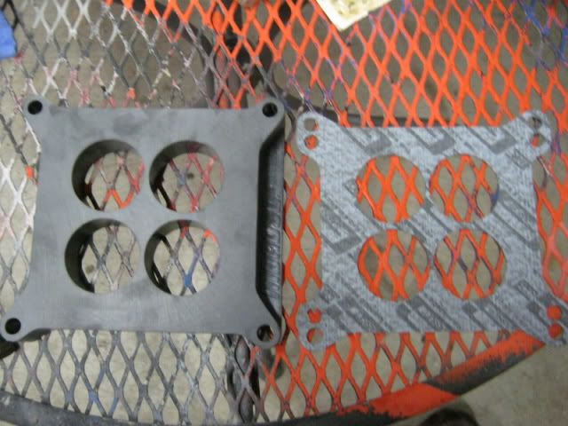

First, if you have a dual plane manifold (4 Holes), You obviously have the Wrong Adapter ! you should have the one with 4 holes ! everyone sells the cheaper 1 big hole adapter, really only good for a spacer on a single plane manifold. but you Can get the correct adapter with 4 "Tapered holes" for going from the spreadbore to the square bore of the holley. that prevents the dead spot that the single hole adapter will cause.

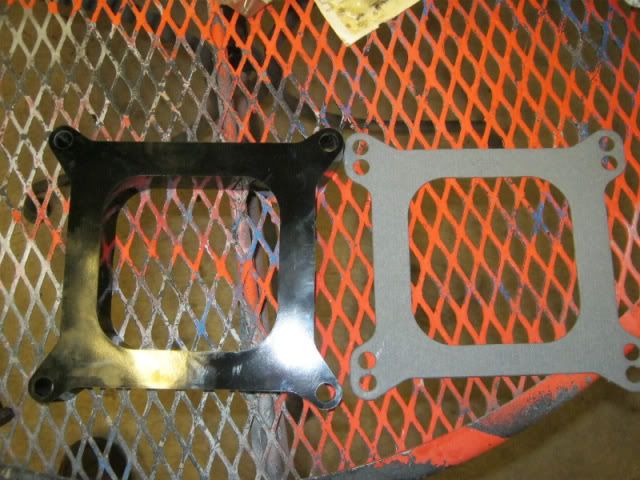

He has a Spread bore manifold and a square bore carb. I had the same setup on my 86 SBC Fiero. I used a square bore moroso plate between the carb and manifild - it was open square bore - not a four hole plate. Worked fine but I was using an Edlebrock carb versus a Holley. I am in the middle of building another 350 with the same setup - spreadbore performer manifold with a Holly squarebore carb. I'm using a "phenolic" (plastic) spacer that is squarebore - not four holes. I understand what you are asking about the porting on the base of the carb. I have asked the same question over on Hot Rodders .com - awaiting replies now. I am not sure if these ports need to be sealed with a 4 hole plate or not. Throttle cable bracket was a modified stock GM/Qjet bracket and a stock 4 cylinder cable.

Porting on the base of the carb, you mean the butterflies right? There doesn't need to any separation of the ports, or barrels after the carb. The intake manifold is wide open right? Those 4 ports should be the primaries (2) and the secondaries (2) and should open when under throttle. The butterflies control the air flow into the intake, after those butterflies the air/fuel no longer needs to be separated from primary/secondaries it all flows together in the intake.
Unless I'm confused on what you mean by ports, in which case a pic would help.

id post a pic but my pip is screwed up and internet is slow anyway but on a 4160 there is a port in the middle of the four butterflies and i cant make heads or tails of it. it kinda looks like just a vacuum port but i figured id ask first

Katatack, I have a q-jet manifold & an AFB, using a 4 hole taped adapter that adapts the big holes to little, little to larger ,Etc.

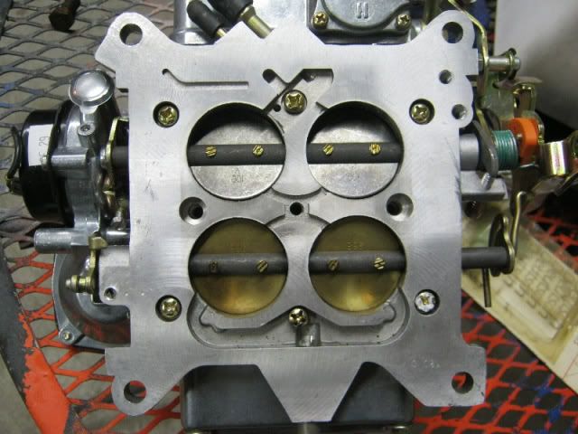

Well I have 2 different answers - which one is correct???? I really do not know but I will tell you what I think. The Holley base plate has ports in it running between the primaries and the secondaries - look like to me they are vacuum ports for PVC, vac advance, etc. One guy tells me it does not matter if they are wide open and another tells me that if it did not matter, why would they be proted to the primaries and the secodnaries. I beleive they are ported to the bores so that if it is sealed to a 4 hole plate or manifold, you still get vacuum on the various ports. But just maybe, the proting is such that it requires the seal to create the correct vacuum in the ports? So, for me, I went and picked up a 4 hole spacer from Moroso and will use a 4 hole gasket matched to my baseplate and mount the carb as designed - to a four hole base - either manifold or plate. Here's some pics:
Holley 4160 600 CFM Vac seondaries
Edlebrock Performer 750 CFM
Square bore - open phenolic spacer
Moroso 4 hole square bore phenolic spacer
After picking up the Moroso spacer, I fit it to the manifold and it seems to make a better seal to the spreadbore manifold than the open square bore spacer - the side walls are a little thicker - and I know for sure it fits the Holley - it's 4160 specific.
To the OP, in my opinion, you should pick up a 4 hole plate/spacer and go that route with the Holley - it may not make a difference - then again, it may make a lot of difference in vac pulse - maybe idle, etc. It was designed that way for a reason - why re invent the wheel.
Like I said above. I had a 600 Eldebrock - brand new on a performer spreadbore manifold with a squarebore - open plate and I could not get the thing to ever idle the same - constant idle changes. I replaced it with a stock Q jet and all those idle issues went away? The Eldleborck was crisper but the Qjet was way better on the top end - I believe that was due to the Qjet being a 670 CFM versus the 600 CFM of the Eldebrock. This will be my first Holley so I just do not know for sure but in the next few weeks, I will as I have both spacers and will try them both.

Again, it does not matter what is under the carb. The channels on the underside of the carb are there so that vacuum is equalized when the carb is mounted on a four hole manifold or adaptor, as it would nomally be on an open manifold.

The ports machined on the bottom go to vacuum ports on the side of the carb. These are termed as full vacuum ports. Generally ports below/under the throttle plates are full vacuum ports. Ports that are sourced above the throttle plates are termed as ported vacuum. Depending on the vacuum required determines which port is used. Example: Vacuum advance uses ported vacuum. Power breaks use full vacuum.
The ports on the bottom of the carb's are designed to use either style of gasket. Using a 4-hole style or the open style will not affect the vacuum ports.
