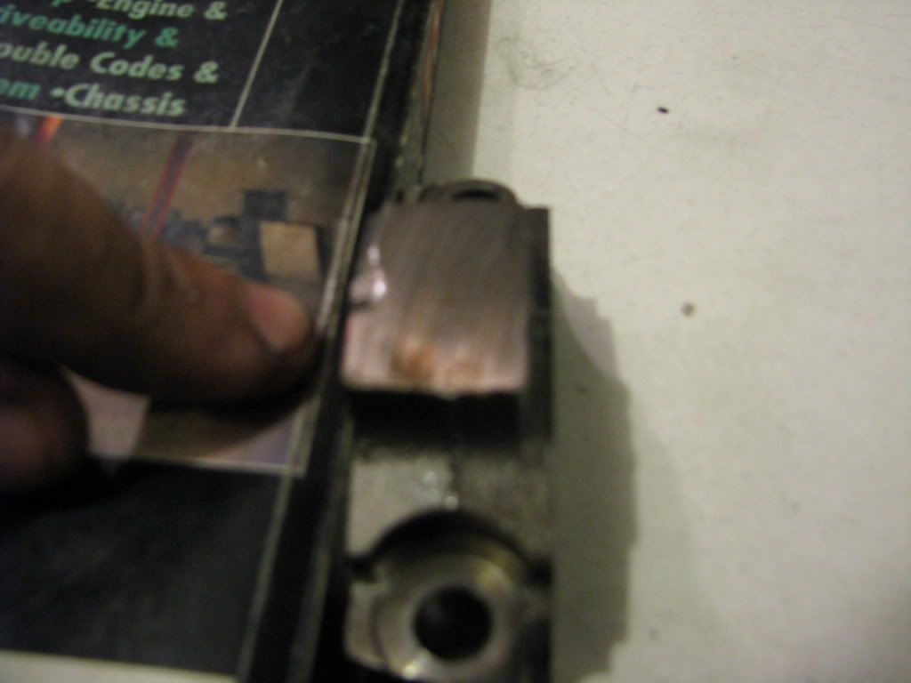

I am rebuilding an 88 Duke that had the force balancer explode on it. Fortunately the previous owner is a mechanic and shut it down as soon as it blew. Hence this engine with it's freshly rebuild head is very salvagable. I was checking clearances on the new crank with some plasti gauge tonight when I noticed the connecting rod cap on piston 3 has a dent in the bottom of it where you can tell the very bottom of the cap was ground.
My question is can I just file off the bur that the dent made since it will scrape the side of the reluctor wheel and the oil pump gear, and re-install? Or is it weighted for balance reasons hence filing off a bur would mess that up. Also it seems to be fine since the plasti-gauge was nice and uniform across the journal. So I don't think it is out of round.

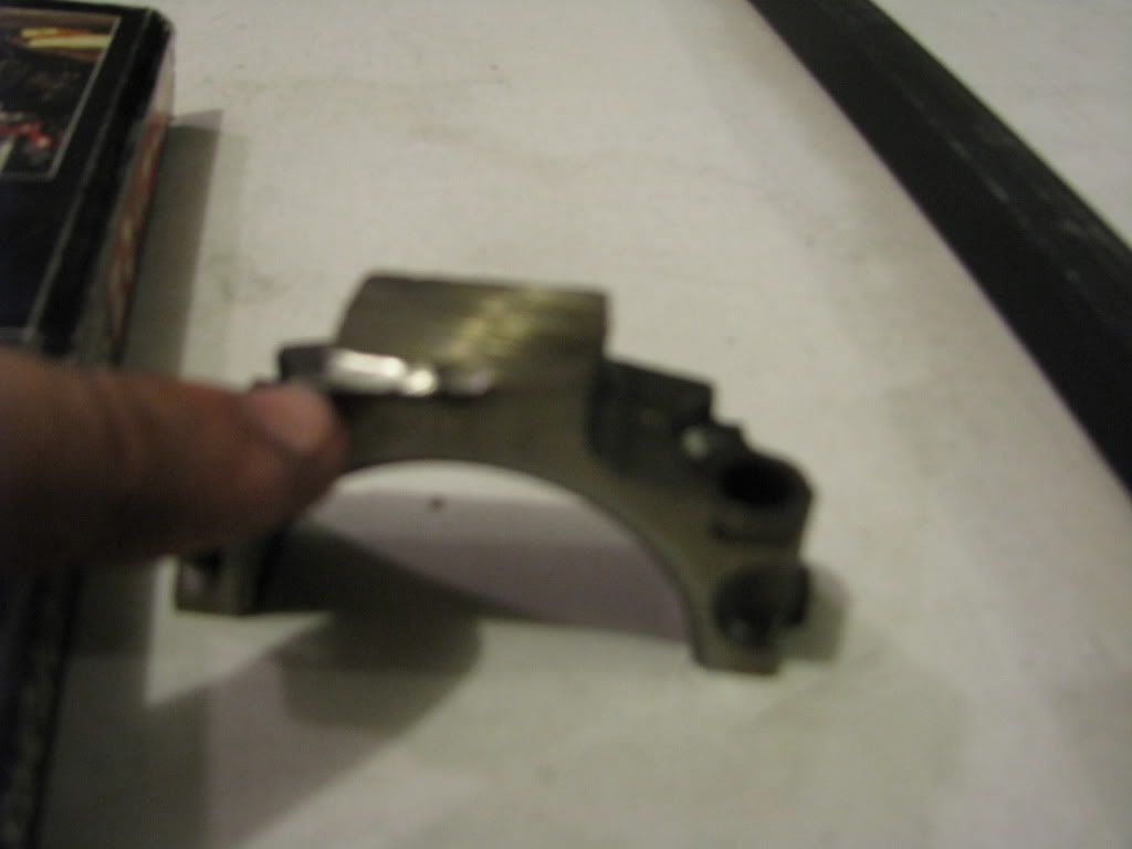

Curlrup
Posts: 2590
From: Havre De Grace, MD
Registered: Apr 2007
Report this Post09-05-2011 08:36 PM Click Here to See the Profile for CurlrupSend a Private Message to CurlrupDirect Link to This Post
Sorry for the blurred photos my camera seems to not be liking close shots tonight.
Francis T
Posts: 6620
From: spotsylvania va. usa
Registered: Oct 2003
Total ratings: 119
Report this Post09-05-2011 08:55 PM Click Here to See the Profile for Francis TClick Here to visit Francis T's HomePageSend a Private Message to Francis TDirect Link to This Post
Hmm,, I'd just smooth it out the edges with a sanding drum, but you may want to get some more feedback on it. The reason being for smoothing out the edges is: sharp edges/burrs can breed cracks and then catastropic failure. Such is why it's a good idea to smooth out the casting seams on connecting rods etc.
Joe 1320
Posts: 947
From: Sebring, Florida
Registered: Sep 2003
Report this Post09-05-2011 08:56 PM Click Here to See the Profile for Joe 1320Click Here to visit Joe 1320's HomePageSend a Private Message to Joe 1320Direct Link to This Post
I would be concerned with a crack forming. That looks like it took a pretty good hit. You could have the part checked at the machine shop for concentricity and integrity, might be cheaper to just get a new cap.
Edit: I re-read and saw it was a rod, not main. Same thing though...... get it checked.

Ventura
Posts: 715
From: Columbia SC
Registered: Mar 2011
Report this Post09-05-2011 09:17 PM Click Here to See the Profile for VenturaSend a Private Message to VenturaDirect Link to This Post
If it were mine, I'd clean it up with a file or dremel tool and reinstall it without any reservations. However, a purist could come up with many objections. I don't think you would have lost enough grams of weight to have a balance problem. Just my opinion and good luck.

Might want to have that rod cap magnaflux for cracks you can't see. Looks like it took a good hit.
Just my 2 cents.

dobey
Posts: 11572
Total ratings: 371
Report this Post09-05-2011 09:53 PM Click Here to See the Profile for dobeySend a Private Message to dobeyDirect Link to This Post
Originally posted by Raydar:
Second this. It's not like it's going to see 8000 RPMs, or the 24 hours of Sebring.
But looks can be deceiving. It could also not even see 24 hours of a running engine, and could cause much worse damage if it fractures. I'd vote to get it checked with proper instruments (not eyes), or just replace the rod. I don't remember how the rods/pistons are married on the duke, so it may or may not be as easy as just pulling it out, and popping the new one in. If the pin is press fit, then it's a bit harder to deal with.

Magna fluxed....no cracks, dyed and checked under a scope. no cracks. Placed in a fixture and checked for roundness. It is round. Gotta love working with a machine shop for a living. So this cap has been precision ground down and will be reinstalled. Thanks folks.
