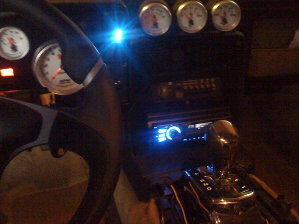

https://www.fiero.nl/forum/A...110502-2-105101.html I put this together to run my 65e. I don't have line pressure control but it does the up/down shifting and disengages the tcc when shifting. Line pressure is maxed out but I've learned to drive with it and nobody would notice if I didn't tell them.
Here is the current setup. I use a cadillac shifter with tap shift and had to use relays and diodes to run the 7 segment display because I didn't have enough outputs. There is a super relay that has pwm and more outputs but didn't look into it. It probably still cost around $300 with the shifter.
