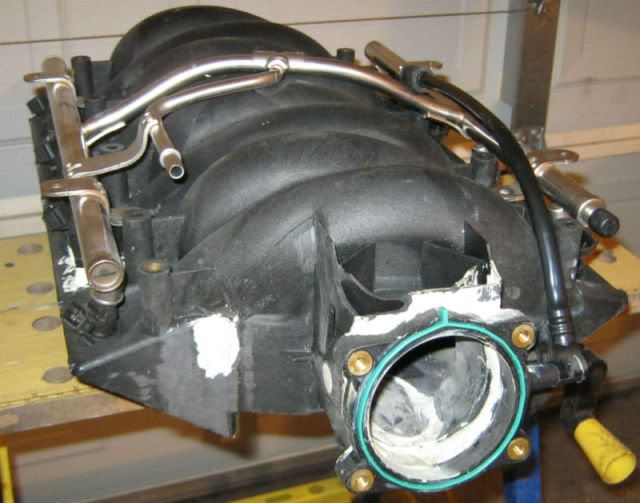

I would like to do some mods to an LS manifold and need advice on welding it.

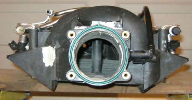

The stock LS intakes are nylon or nylon 6-6. Lots of people have used epoxy or JB weld to perform some modifications to them - like cutting the center supports out of the LS2/LS3 intakes and filling the 1" hole this modification leaves in the base. I used JB weld to seal up a DoD connector pocket I made on my LS2 intake (haven't tested it yet).

I had an idea to weld the LS4 TB mount flange in place of the LS1 flange on my LS4 to LS1 manifold swap to avoid makeing an adaptor.

TIPS offers the service of grafting the LS2 throttle body flange to the LS6 manifold, they could probably do the LS4 to LS6 one as well for extra $$$.
http://www.tpis.com/parts/view/39
One guy has already performed this LS6 intake with LS4 throttlebody mod and the manifold was for sale on ebay a while back:
http://cgi.ebay.com/ebaymot...fPartsQ5fAccessories
