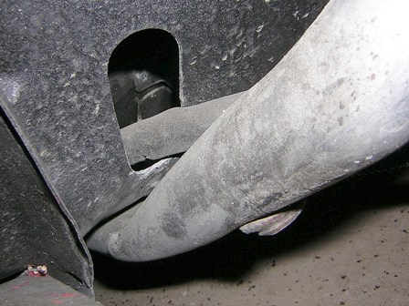

I ran a search and could not find anything that mentioned bending the tube back enough to ensure good flow.

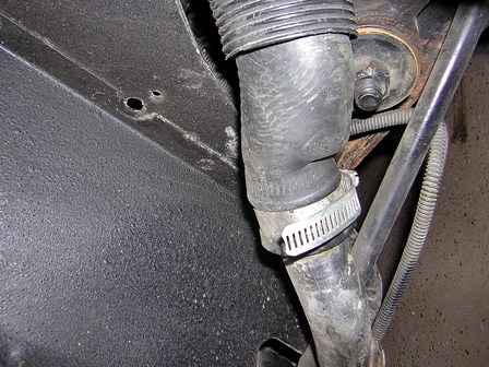

I was under my car this evening trying to figure out why my engine coolant hose on the drivers side is at such a different angle coming into the coolant tube. So I took off some of the wheel liner bolts and pulled the liner back and found a kink/bend on the top of the coolant tube. I have pictures below. My question is the stainless tubes material substantial enough to be able to pinch back with BIG channel locks?

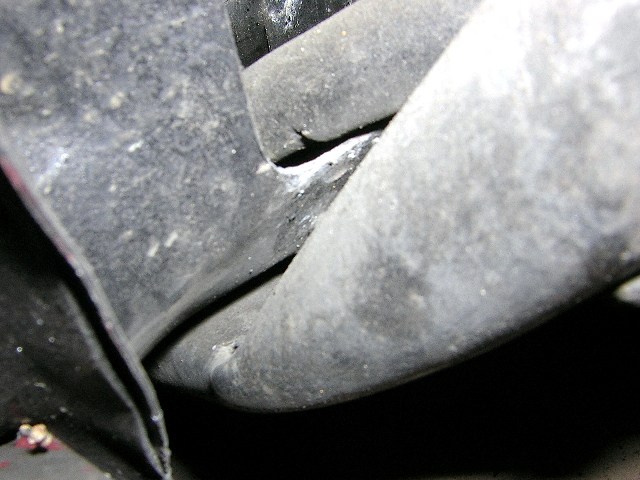

You can see in the last picture where the rustproofing that was on the tube cracked off at the bend. Looks quite sharp. This is what a GM dealership did.

You might be able to get it back out if you pull the tube from under the car and heat it up really good around the bend. Other than that I would think it would crack trying to get some of its shape back with just channel locks.

i to thought about bending it back but you probably will get it to the stock curve but will still have a kink.
if not a crack. you could just cut that bent section out. and replace it with a rubber coolant hose and a clamp at both ends. which ill end up doing.

Lower the coolant tube down so you have some access to it, cut the kinked section out. From there you can either just use a section of hose to make the repair, or you can weld it back together.

I fixed one of these bent pipes by getting the last 36" of an unbent pipe. I then cut off the smashed piece about one inch short of the 36" mark. Used a piece of radiator hose and 4 clamps. Four years later it is still doing good. I used a small hammer to open up the hole just enough to replicate a flair on the long portion still in the car. Make your cut between the two pipe fasteners so they will assist with the holding on the new section. Turn the 4 clamps so they do not interfear with the pipes going up against the body of the car.

The best fix is to cut out the bent section and weld in a new piece. It's more expensive but will last forever.

cut the pipe.
then, you can attempt to expand it back from the inside, maybe using a tailpipe expander, or cut out the crushed section, and replace with radiator hose, or another section from an unbent tube.

I marked an X on the top and bottom crushed part of the tube, then cut the tube directly in the center of the crushed area. Then I expanded the pipe on both sides back to normal. Then had chrishahn TIG it back together.
