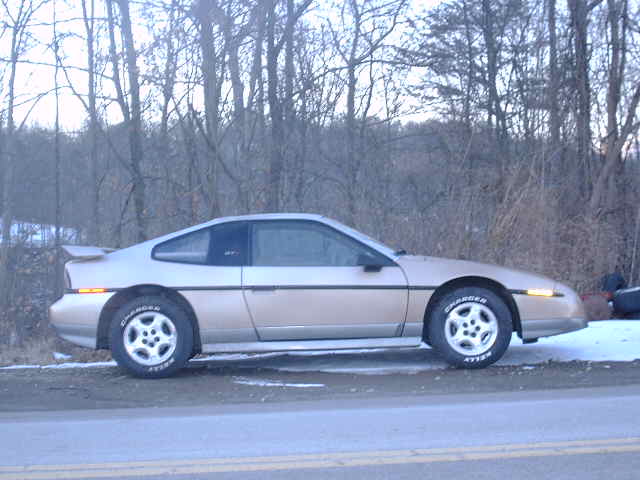

Well, I searched "Neon" in Tech, Gen, Arch Tech and Arch gen. All I found was this car with 14" wheels from a Neon.
Considering this topic was about the 15" wheels, maybe you could direct me to this "post" you mention since I am not able to find it.

according to tirerack.com a 2004 neon srt4 is 5x100 bolt pattern so the first pictured wheel should work cause those are srt4 rims
