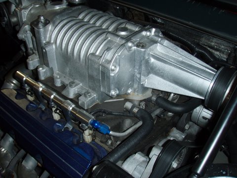

Fiero Flyer is correct about the slightly lessened room between the strut towers on an 88. However, you can get a very nice looking installation in the 88. I have a 3800 SC Series III in a 1988 GT that looks very nice (IMHO).
Nelson

Looks great! You guys have me excited! Me and a buddy got the integra running and about ready to sell. Hopefully I will have it sold in the next couple of weeks.
