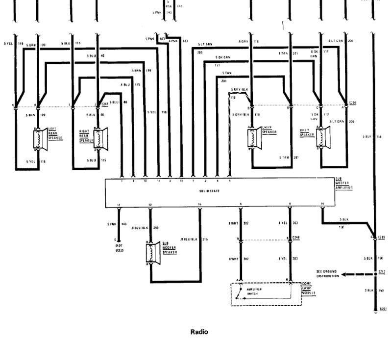

Looking for a wiring diagram for the factory audio amp. I'm wanting to use the factory wires on an after market amp. I would still like the slide switch to work. As you guess the factory amp is gone! Putting a new sony deck in and have the wiring harness adapter. Any help will be appreciated.

pulled from the service manual:
