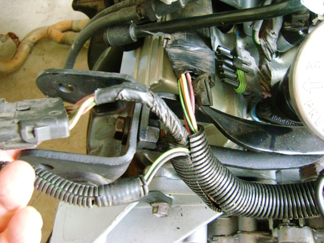

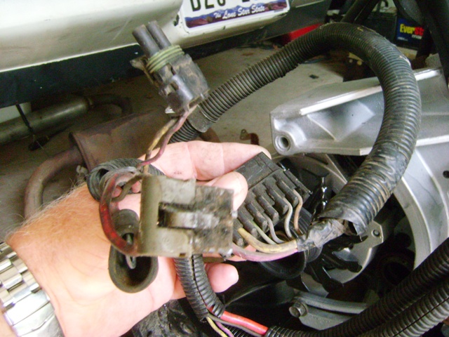

Here are a couple pictures of the area you're talking about that might help... they're from a customer's car before I tore it down, so it's a bit dirty but they get the point across:

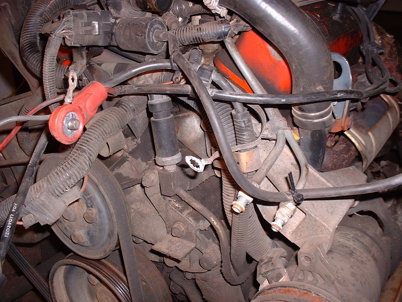

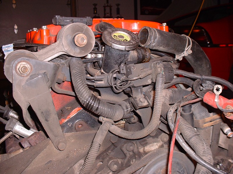

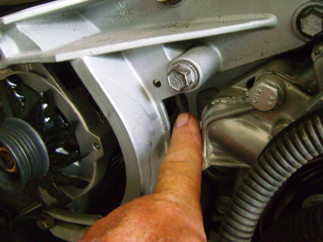

This is the Alternator, VSS and Transmission switch wiring.
On my engine the alternator harness went threw here. Was a stick shift I am thinking, so for an automatic do they both go threw here?:
Injectors and the MAP connectors. Over , under or threw this black dog bone bracket?
