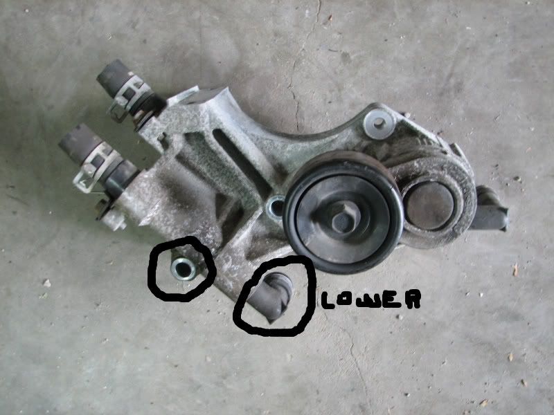

Factory bracket? Installer error? This is bone stock with factory alt bracket, factory tensioner assembly and alt in stock location, not a low mount setup.
Here's an internet pic I found. The unmarked one to the far right (not the circled marked lower) popped out at high rpm's. It just slips in, how can it be "an installer error"?
Here's another internet pic showing nothing holds it in. I propose a small bracket to hold it it.

when we do the swaps we drill and tap that hole and install a 3/4 NPT fitthing and run the hose from that some others have built tabs to hold them in and some others block them off.
I would not recomend the block off we have tested one that was and the intake was almost 60 deg. hotter on that side than the other due to no flow.
you can just see it in this pic. I will say it is not easy to drill and tap because the hole is large almost an 1"
