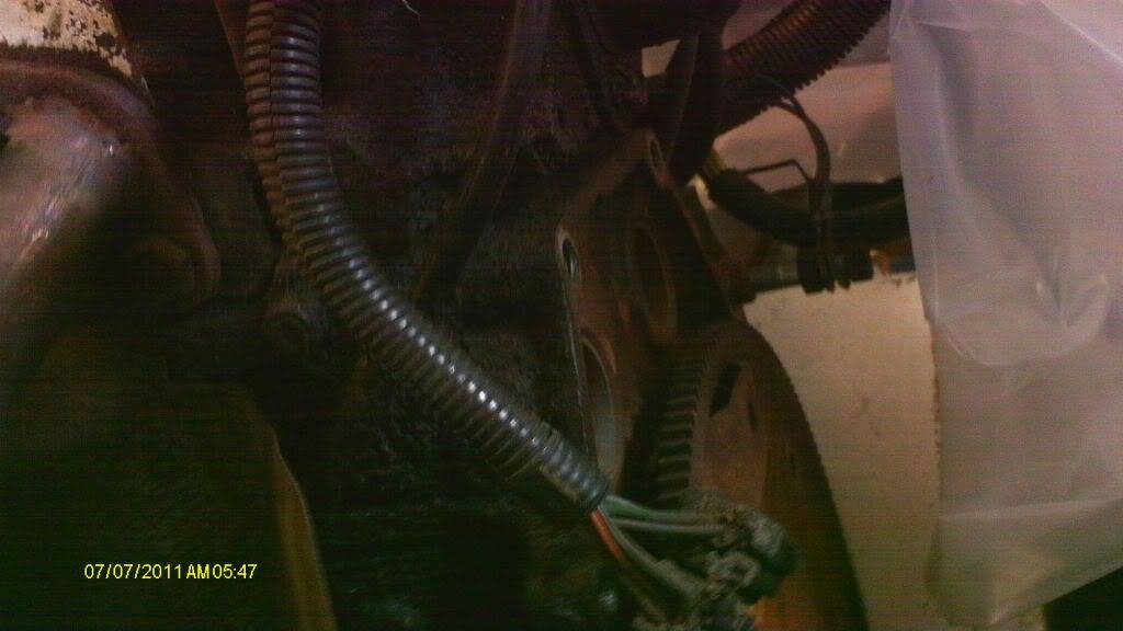

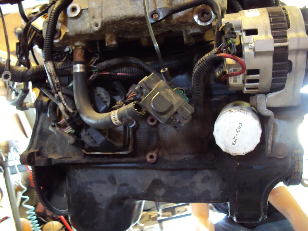

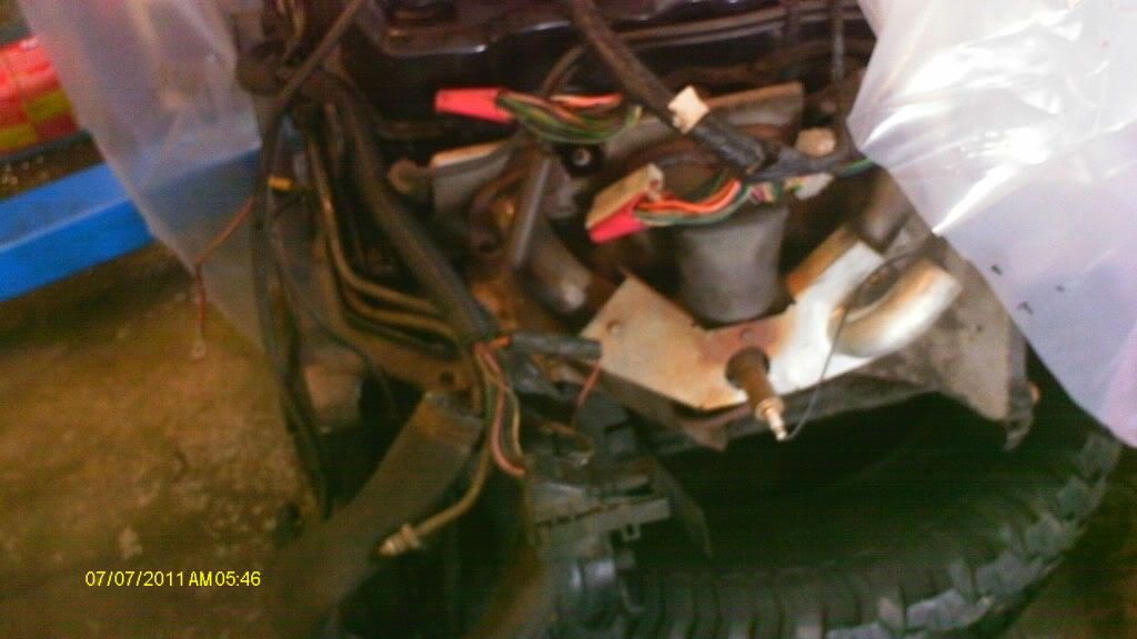

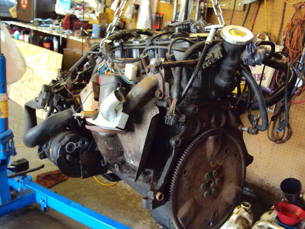

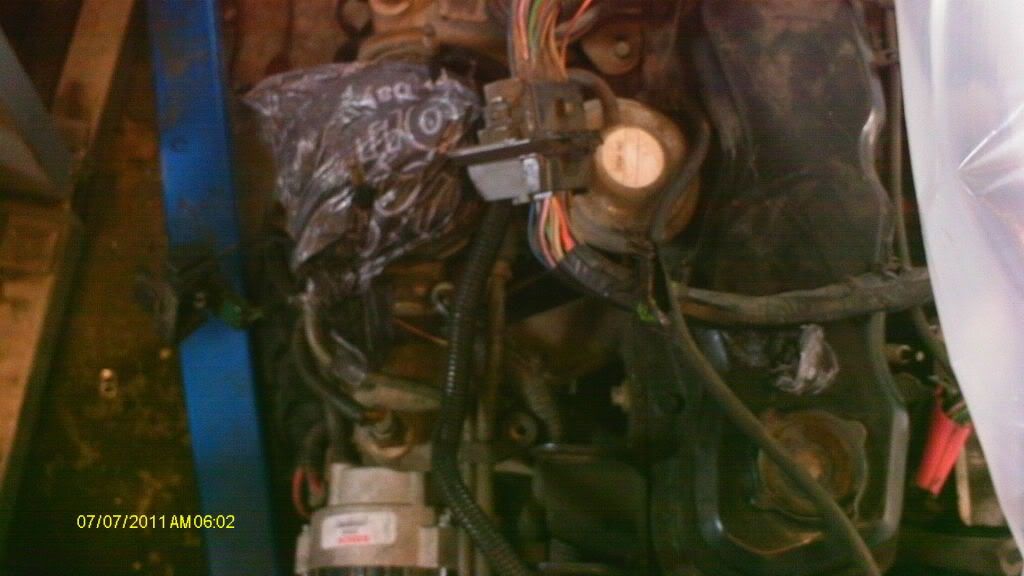

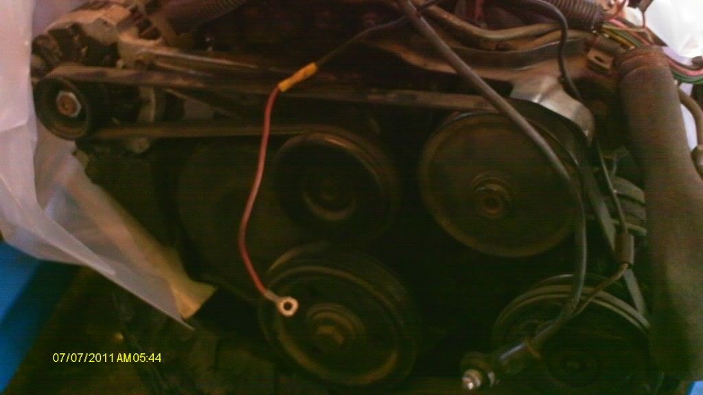

I picked up this engine the other day for an 1985 fiero I started comparing my engine to this engine and realized a couple differences to mine and my dad's fieros. Here are the pictures. I am just wondering if this is really an engine out of a fiero.

looks like an 88 to me.
-Dave
Or an 87. Look under the oil pan. If there's a 4-inch removable plug, it's an 88.

It has a serpentine belt, which means, if it was a Fiero Engine, then it is an 87 or 88. These engine use a different computer/ignition system and will require some re-wiring to make it work in an pre-87 chassis. Can you locate any stampings on the engine to tell you which Vin it would have came from?
BTW, the 87-88 didn't have a heat riser on the exhaust manifold, so there is a chance this is not a Fiero engine, or the exhaust manifold was changed.

Does NOT look like a Fiero engine, probably the oddball VIN U engine. If you wanted to put this engine in an 84, you'd have to reuse the 84 head, which will NOT bolt up to a VIN U block.

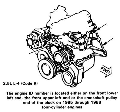

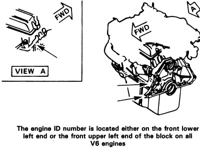

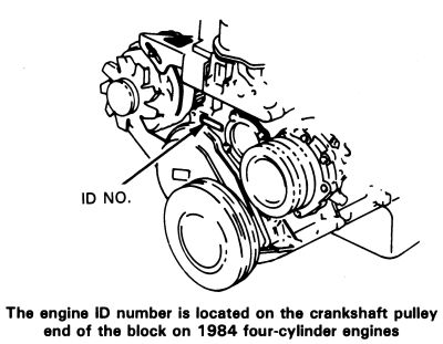

Here are the Fiero engine ID number locations:
I have checked a few "R" dukes for numbers in these locations and have only found one that had stampings at any of the points indicated. I just went out and checked the one in my garage and the only numbers on it are the casting numbers on the side of the block near the dist hole.. Nothing on the timing gear end or on the fly wheel end

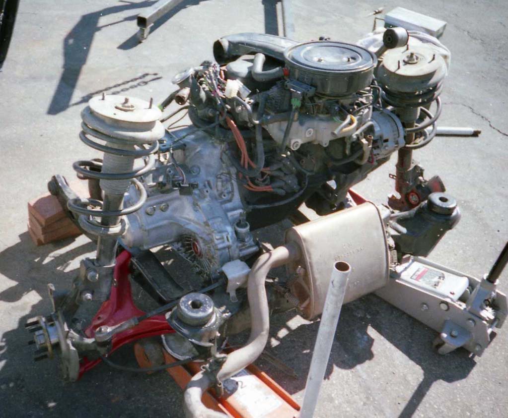

The first thing I see in the pic is that the engine has an idler pulley and a serpentine belt. That by itself would make it an 88 engine. Second, I see a heat shield around the O2 sensor. I have an original stock 88 and it doesn't have that shield.
Third, Spark1's info about location of the starter on FWD engines. They are on the left or front side of GM FWD motors, just like the Fiero.
Fourth, Kwh. The OP's engine is a cross flow head design as are all Fiero 4 cylinder engines. Intake on one side, exhaust on the other.
As suggested by others, best to check the numbers on the engine for a positive identification.
Or an 87...... As previously mentioned.....

Well, if it is a fiero engine, we have established that it is either an 87 or 88.
Did the 87 have the distributor, or did it have the coil pack like the 88? the pictures do not show under the intake plenum.
Looking at the oil pan will verify an 87 or 88+.
So wait where it says fw is that where the starter should be mounted at???

It has a coil pack
Yes, and on FWD engines the AC compressor is usually mounted where the PS pump is in that drawing.
Thanks, Joe. I didn't know the 87's also had the belt tensioner. I guess the quick way to identify it would to feel the bottom of the pan for the oil filter plate that TopNotch described. If it's there it's an 88, if not then 87.

Coil pack (back) side, 88, 2.5L:
It was taken when I put it into my 85, so there are 85 parts around it, but the engine is full 88.
For reference, here is an 88 exhaust side (just pulled). The old 85 engine is in the same picture. Note the oil filter and distributor location on the 85. I believe the 87 also has the filter in the same location.
88 oil filter is in the oil pan. Also, the starter is on the exhaust side of the Fiero 2.5L 4 cylinder engines.
-Dave
adding: Forgot the second picture...
[This message has been edited by IFLYR22 (edited 07-16-2011).]

Ok i got more pics of the engine I am almost positive this is a fiero engine but here are some more pics. I am mostly thinking about selling it my uncle said that the brackets on the engine is correct i just want to make sure its an 87...
[This message has been edited by Robbie D (edited 07-21-2011).]
IFLYR22
Posts: 1775
From: Tucson, AZ.
Registered: May 2007
Report this Post07-21-2011 12:17 PM Click Here to See the Profile for IFLYR22Send a Private Message to IFLYR22Direct Link to This Post
That definitely looks like an 87 Auto transmission setup to me.
Serpentine belt,
external to the oil pan oil filter,
coil pack instead of a distributor...
A/C compressor on exhaust side.
I have never seen that heat riser on the exhaust before, but it may be something someone else added. The rest of it says 87 2.5L 4 cylinder for a fiero, to me.
-Dave
