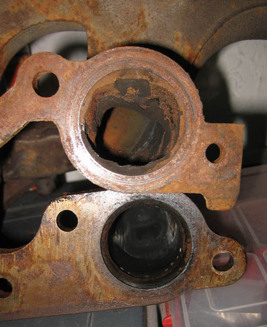

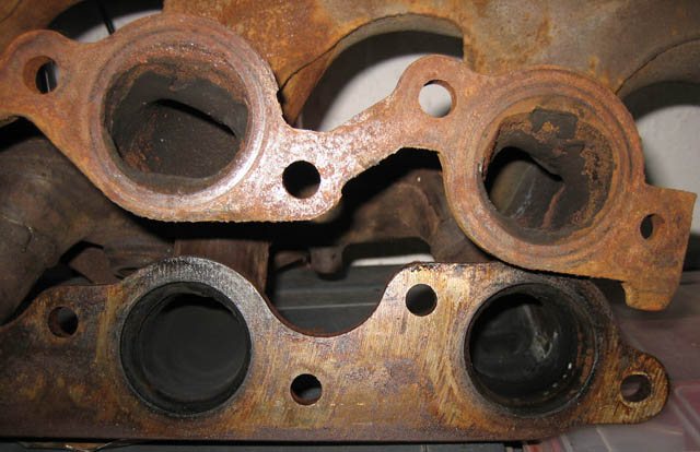

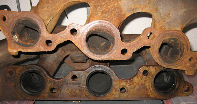

I took the manifolds off today. I can only say wow! Now I see why the ZZP p-log makes some sense. Anything can be better than that rear manifold (do I need to mention top one?)

I meant the stock manifolds, like this. https://www.fiero.nl/forum/F...ML/101909-3.html#p97
I was thinking they weren't as "long" for some reason though. But they are less restrictive than the stock FWD 3800 manifolds. But custom headers are probably the best option. Especially given the pricing for these: http://www.westcoastfiero.c.../3800_series_ii.html
