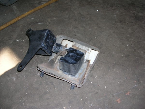

Motor mount. They are rubber and they rip open......I think I have a picture of one of mine here someplace.....
