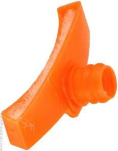

Not just a breather... Air intake filter for PCV system.
They put a small filter in main intake if the engine gets too much blow-by for PCV can handle. Location of filter is backup for PCV. That way oil etc gets sucked in to engine in two places not all over the engine bay, ground, road,,,,
Many use this kind of "Breather"
And some engines don't use a separate filter. They pull air after main filter.
