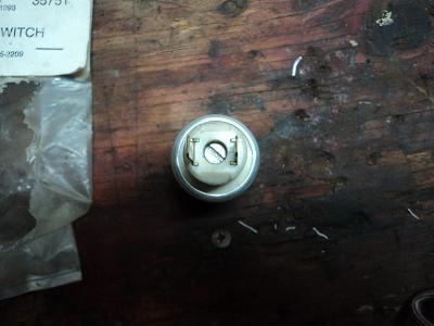

Tommorow , i think you have an 88 ? take the connector off the switch and look , you will see a screw there , that is supposed to be the adjustment . I did it a few years ago but just don"t remember how .

IIRC the switch is adjustable by a screw, accessible when the switch is removed. It's been awhile since i've seen one, so I may be mistaken.

Accessible when you undo the connector .
Yes that is an adjustment , you can read it on the first line on the label but the guy at the A/C place told me not to play with it .
