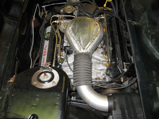

Originally posted by Reallybig:
When you say "custom mounts" do you mean even the transmission or just the engine?
It all depends on how low you want to go and if you want to keep the engine level. In the swap in the picture I modified the transmission brackets (parts that bolt to the transmission) to lower them about 1/2" and then made the front mounts to keep the engine level and square. To go any further would have required a slight notch to the cradle for transmission clearance.
