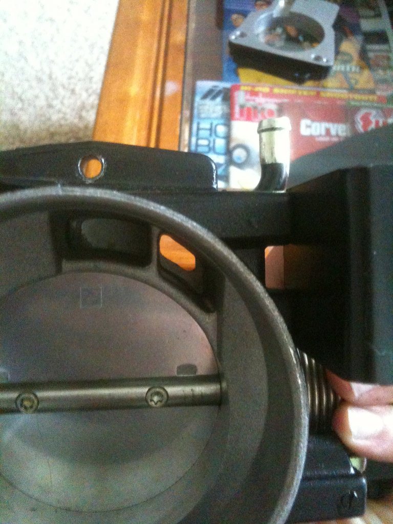

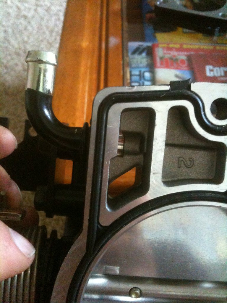

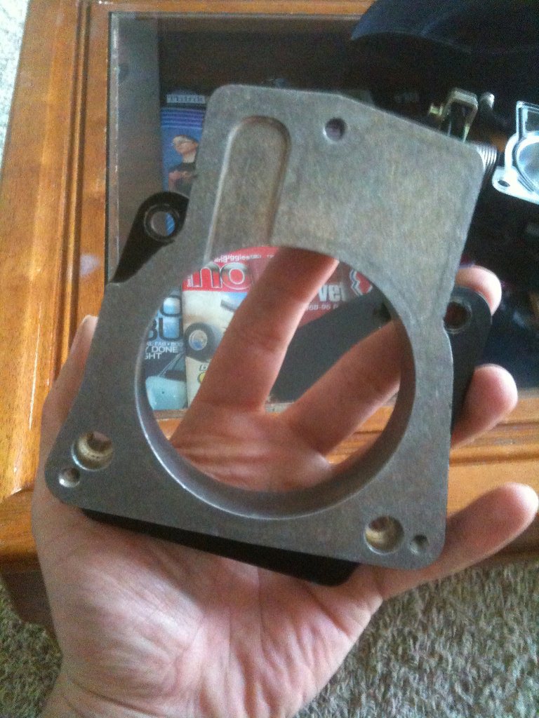

americasfuture2k
Posts: 7131
From: Edmond, Oklahoma
Registered: Jan 2006
Total ratings: 105
Report this Post05-13-2011 07:46 PM Click Here to See the Profile for americasfuture2kSend a Private Message to americasfuture2kDirect Link to This Post
Originally posted by Darth Fiero:
Should be fine hooking it up that way AS LONG AS that port on the top of the throttle body is for a breather tube and it isn't a vacuum port. I'm pretty sure that port on the throttle body he's got the breather tube hooked up to is for the breather and it doesn't lead to vacuum. The way to tell is to find out what side of the throttle blade the passage that tube runs into goes to. If it leads to a passage between the throttle blade and the supercharger housing, then it is a vacuum port. If it leads to a passage that faces outward from the engine (on the side of the throttle blade that you would hook your induction tubing to), then it is for a breather.
here are some pics of my tb. his is also the same one i have, the N* tb. the port leads to after the blade, but that passage has an opening that goes to before the blade. im assuming this is the correct spot to hook up the PCV hose.
back side of tb
front side of tb
passage for that port on the adapter plate.
[This message has been edited by americasfuture2k (edited 05-13-2011).]

Darth Fiero
Posts: 5922
From: Waterloo, Indiana
Registered: Oct 2002
Total ratings: 361
Report this Post05-14-2011 03:50 PM Click Here to See the Profile for Darth FieroClick Here to visit Darth Fiero's HomePageSend a Private Message to Darth FieroDirect Link to This Post
back side of tb
front side of tb
Looks fine to me. You should be ok using this port as the breather hookup. The adapter plate blocks off the back portion where this tube dumps into and only allows fresh air to enter from IN FRONT of the throttle blade. This setup will be fine for a supercharged application.
