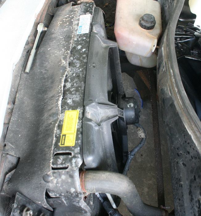

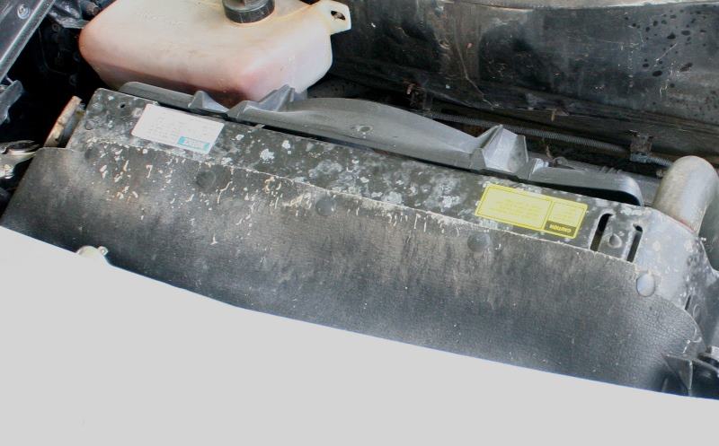

Report this Post05-22-2011 02:18 PM Click Here to See the Profile for JohnWPBClick Here to visit JohnWPB's HomePageSend a Private Message to JohnWPBDirect Link to This Post
Here are a couple of photo's of the air dam:
It basically just helps to force the air through the radiator, and keeps it from going up over the top.
