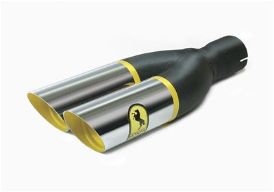

I have a 4.9 straight out to a y splitting to 2 Monza exhaust extractors. No other mufflers sounds great.
The cost about $90 each at summit racing.
Do these actually quite down the exhaust. I've seen these and I'm not sure about the color. But if they work I wold be interested.
Flowtech 59905FLT at summit are cost 39.95, have the exact same layout, and are black inside instead of yellow. I have these, but they were branded by Hooker Headers at the time, the parent company is Holley for both.
