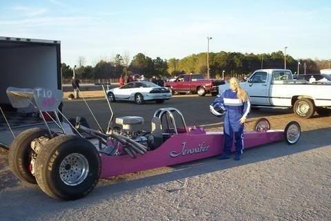

Jen's rear engine dragster at Kinston Motorsports.

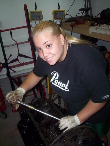

Jen building one of her small blocks.

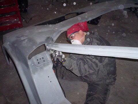

Jen doing fiberglass work on our Lambo kit. We finished it a couple years ago and sold it.
