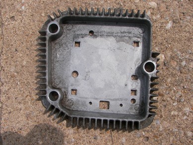

87-88 Does have a shield.
Get replacement shield.
Try GM parts
Try Junk yard. Any VIN U or R will work. For List, see cave, dis replacement. Try later year, GM updated tray with fins.
Or make one... Doesn't have to be exact.
dielectric grease is ok... Heaksink compound (White, silver, and gray common colors ) is better. get it at radioshack, maybe Best Buy, or any computer place.
