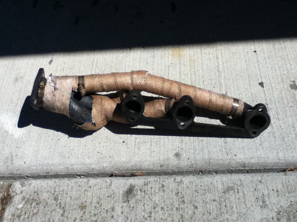

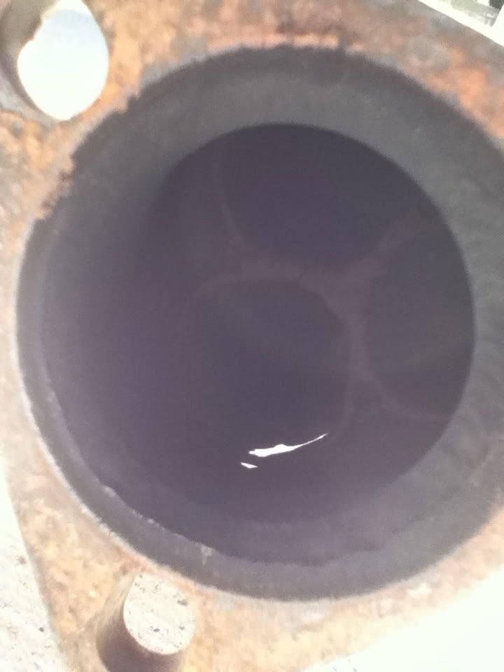

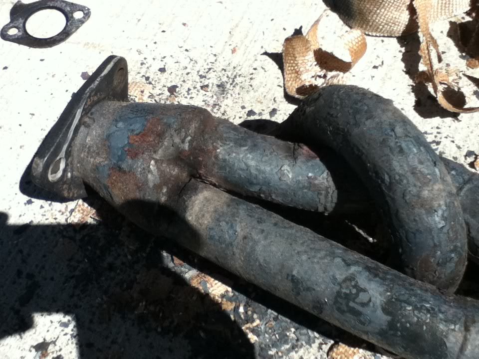

Well I have heard many things about wrapping headers, some pro and con but could never get a real difinitave answer or pics of headers damaged. Well here is an example of the material breaking down under the wrap. It does not look like rust but the mild steel just flakes off like bad rust. I had an exhaust leak developing over the last month and finally got the header unwrapped to take a look...
The wrap had become very brittle and sensative. Easy to damage.

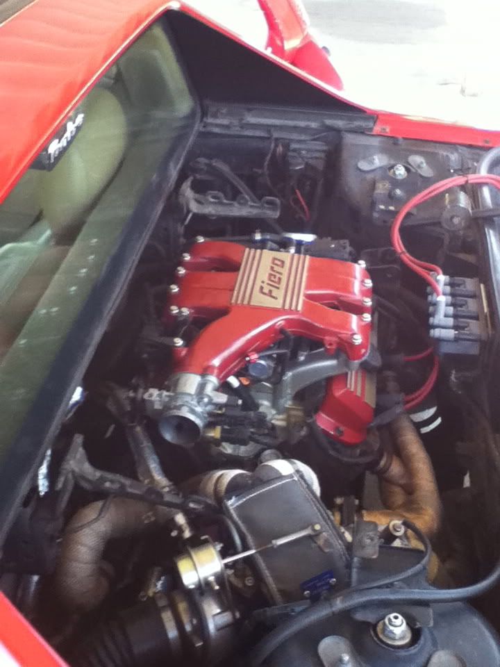

At this point I will be rebuilding the complete exhaust before the turbo. Similar to the way MIDTRBO is set up.
http://myfiero.com/uploads/20207_.jpg
This will be more compact and simpler and should be stronger.

I wrapped the headers less than a year ago, about 10 months ago. At the time I had them sandblasted and I coated them with lots of spray on ceramic coated, cured properly of course. They were sound with very little external corrosion. I just was having a hell of a time keeping under hood temps under control.
I do not think rain is a factor as the car is covered most of the time and not driven a huge amount in the wet weather. I think it was just heat that accelerated the break down process.
These headers are just mild steel and with the turbo being operated MUCH hotter than they are designed for. Stock headers are some form of stainless steel and do not get nearly as hott as these do.
My new headers will be T304 Stainless with heat shields, no wrap. Also simple log type, no long tubes and much simpler.

Depends on the headers. If they are mild steel then no its probably not a good idea to wrap them. You could paint them with high temp paint but I don't trust the spray paint to hold up. If you ceramic coat them then wrap them you would be fine.
Now if the headers are stainless steel then there isn't a problem with wrapping them. I don't understand why some people think header wrap with destroy stainless steel.
Generally header wrap will break down over time. Better quality header wrap will last longer. Its also a good idea to "seal" the header wrap. If you read the instructions with the wrap they usually suggest you to spray the header wrap with the high temp ceramic spray paint. The paint holds up better in my experience when sprayed onto the wrap. Painting the wrap helps the wrap to not absorb water, dirt and grim as easily.

Header wrap can ruin even ceramic coatings if it gets wet often enough or is allowed to suck moisture from the air. I had a leaky rain tray on my 87GT decklid and the forward header lost most of its ceramic coating. If you're going to race the car and keep in a garage most of the time, wrap them. You can also add one or two underhood fans to help displace the heat. We do not recommend heat wraping our headers.

Embrittlement causes the destruction of headers that are only coated outside and not inside, or are wrapped. Stainless is still subject to heat related embrittlement from being wrapped.

Water itself isn't corrosive but the fact it carries oxygen very well makes it a bad idea to do something that keeps it in contact with other materials that can corrode. Header wrap does exactly that, and since all chemical reactions (which is what rust is, O2+Fe = FeOx, iron oxide, rust) are sped up by heat, having heat wrap on a hot exhaust makes it that much worse.

Those look just like the headers that I used to have on my car. I wrapped them and in less than a year they were junk as well.

Our rule of thumb is to never wrap mild steel and wrap stainless steel. Jet Hot looks great, but does not reduce underhood temps (I have the burns to prove it). Wrapping allows you to grab the exhaust pipe after a hard drive.
When you make your headers, make sure you are welding with stainless wire or the welds will rust out.
