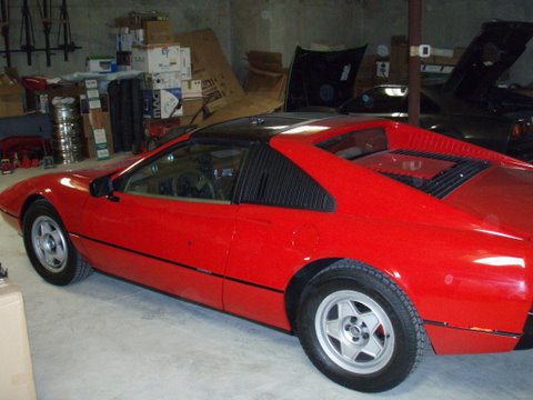

I have Rodney's one inch lowering ball joints on an 88 and coilovers on the rear. I have been running the Rodney ball joints for about three years without any problems. The pictures may give you an idea how they look on my car. BTW, I have 265 x 50 x 15 tires on the front and rear.
