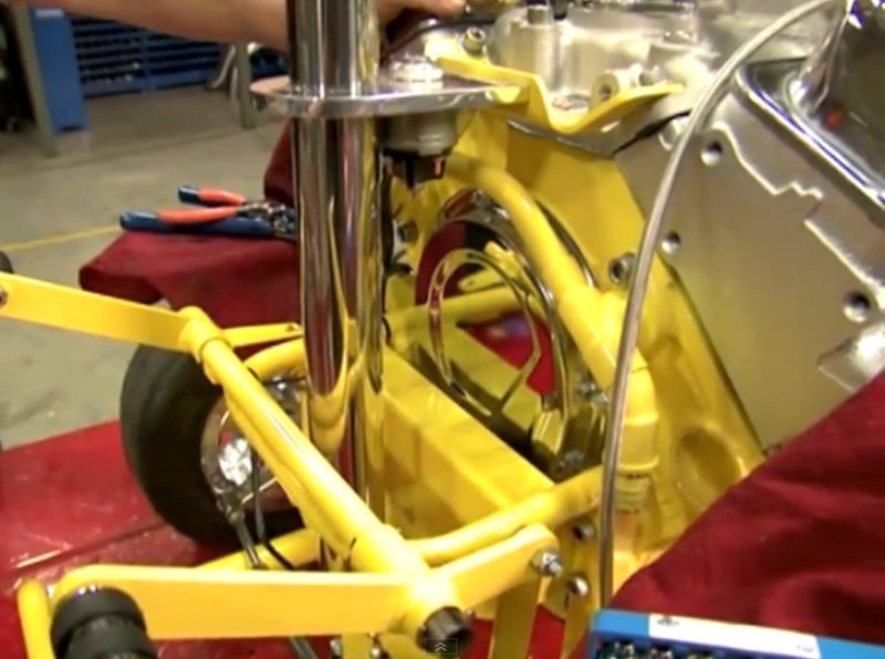

I just saw on Stacey David's 'Gearz' an episode where he's putting together a V8 barstool out of a kit, using a 305, and it has a remote mounted water pump, with some tubing mounted to the front of the engine where the pump would normally go, and the remote pump mounted on the frame

I've had customers that used the manifold & remote pump like Stacey David did on 'Gearz' a few years ago when he did the bar stool.
We've used the CSI-901 pumps that bolt onto the engine, & the CSI-925 Remote pump.

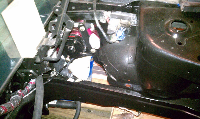

I followed Archie's suggestion and used the Mesiere remote pump - mounted in the space between the chassis and the passenger quarter panel. At first I was worried that it would not move enough coolant but I have had no issues. Once I installed the extractor scoop and got the front defelector repaired, I can drive it around town with out running the fan. I used a 180* Tstat. On the interstate at 75 plus, the temp will creep to just under 200* on the aftermarket gauge. It was 90* here yesterday and I put nearly 100 miles on the car - both in town - stop light traffic and up on the hiway. Never went over 200*! Cost a little bit but it works great.

i have mine where the battery used to be.
