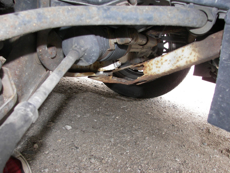

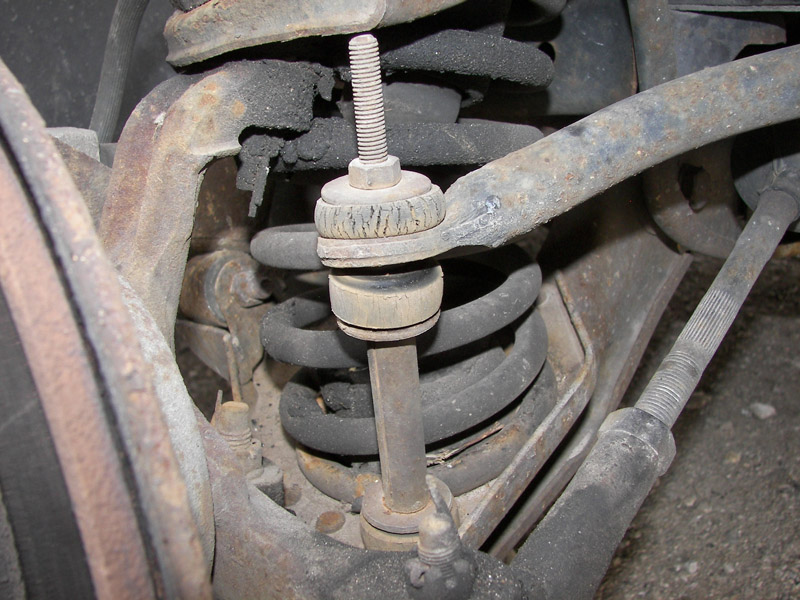

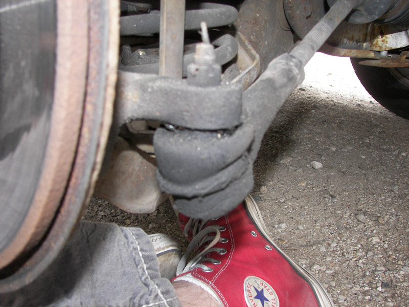

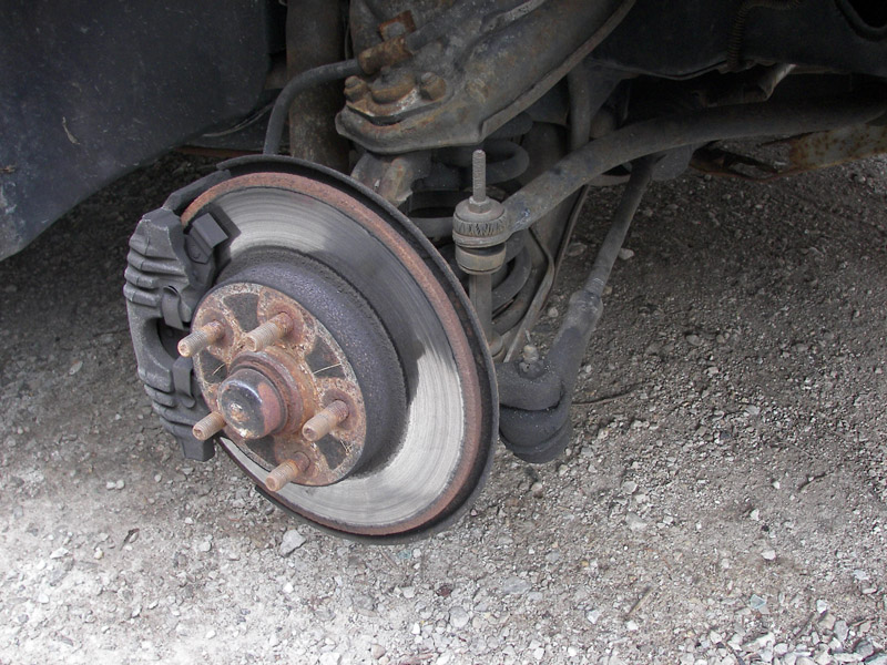

Well, getting ready to tackle this soon. Took some pics and videos of the suspect front pass. wheel. I believe this wheel wandering is the cause of my symptoms. What do you guys think?
Pic of the whole assembly.
Not too sure what I'm looking at here, looks like the sway bar end, but I don't like the way that looks.
Yikes! look at that rusty brace! There's nothing left! The other side is still solid. Whatever....
Not liking the look of this very much either....

What you need to do is have someone shake the wheel and you need to determine where the slop is coming from
Inner tie rod end?
Outer tie rod end?
Ball joint/A arm bushings (not likely for the movement shown)
Steering rack bushing?
Rusted out rack mounts? (prob not)
Put the car up on stands and take the boot off of the that end of the steering rack. Have someone shake the wheel back and forth as you did an see where the movement is coming from. A worn out steering rack bushing can allow that end of the rack to move up and down and give you slop. Good news is with that much you should be able to identify where the slop is.
Sway bar bushing - yeah that is kinda how they all look. You can replace them but it's doubtful that you will feel any difference.

Take the wheel off, check if the upper control arm, if it has a lot of slop in the upper control arm. if the upper bolt wiggles a good amount it's because the sleeve that the bolt goes through is egged out.
rourke_87_T-Top
Posts: 1347
From: Toronto Ontario Canada
Registered: Jan 2009
Report this Post05-05-2011 05:09 PM Click Here to See the Profile for rourke_87_T-TopSend a Private Message to rourke_87_T-TopDirect Link to This Post
rourke_87_T-Top
1347 posts
Member since Jan 2009
Because the upper bolt is harder steel it wears out the softer steel on your front crossmember sleeve, when you remove the bolt you will see it will be shiny and worn on the ends from oscillating in the crossmember sleeve. I went through this last year on one of my cars, I strongly suspect that is your issue. I e-mailed Rodney about redesigning the upper bracket that attaches to the spaceframe to hold the bolts on the outer ends to help prevent them from oscillating as much. Crossmember sleeve is like a weak wrist , too small. or a small hinge on a heavy door. I had to replace my entire front crossmember. had to edit a couple times to best explain.
