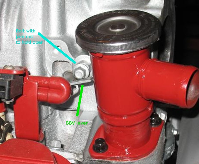

If you want to totally get rid of the vacuum diaphram and solonoid you will need something holding the lever open, If you want to keep the BBV function you keep the vac diaphram and remove the electrical solonoid. Mine has been running around 8 years with the entire BBV system removed and held open, no problems and get 30mpg with an auto trans.

Report this Post03-17-2011 08:56 AM Click Here to See the Profile for Mike GonzalezSend a Private Message to Mike GonzalezDirect Link to This Post
Mike Gonzalez
5093 posts
Member since Jul 2001
Here is one pic I found you can kind of see with it totally removed and open.

Report this Post03-17-2011 09:11 AM Click Here to See the Profile for jackkthorpeSend a Private Message to jackkthorpeDirect Link to This Post
Thanks Mike that is the pic i was looking for!!!!!

Do like the pic Mike shows ya, that is fine and does work.

What MIKE and REVIN are talking about doing is removing the bypass valve actuator from the blower and rotating the valve around backwards and holding it closed with a bolt or other means. This will effectively put the supercharger into a mode to produce boost all of the time, whether it is required or not. Doing this will NOT increase engine performance but it can make the blower work harder since it will be trying to build boost pressure at all times (during all engine operating circumstances) whether it is needed or not. If you remove the boost bypass valve actuator and do not rotate and hold closed the boost bypass valve, your supercharger will never be able to make boost.
If your goal is to clean up your engine by removing the boost bypass valve actuator, you can certainly do what MIKE and REVIN suggest. I don't remove them on swaps I do (unless the customer requests it) because there are no performance gains to be had from doing so aside from the cosmetic "gains" if you want to call it that.
Here's a picture of what you should end up with if you only removed the boost solenoid (but left the actuator intact and functioning)...
