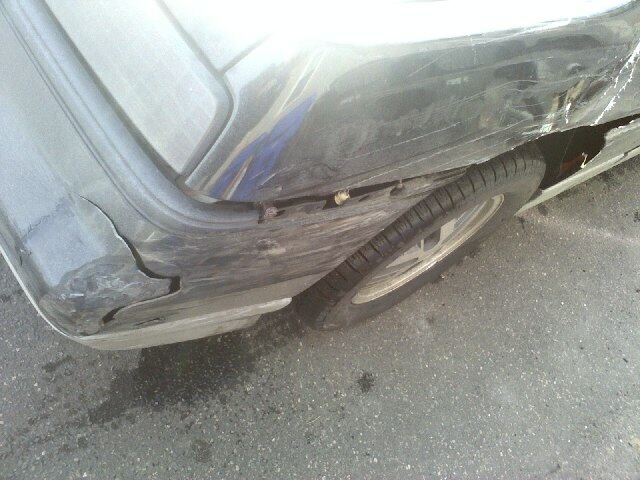

what would be the best way to fix my bumper, without buying a new one.

Haw bad is it ? Fiberglass wont work because its rigid and the bumpe is flexible, so it will crack where the two meet. SEM make a product called "problem plastic" that you can get in an epoxy sized tube for about $20 that works well. There are other products that you can get in larger tubes, but they usually need a special applicator. If you have a tear you can reinforce it on the backside with nylon screen and problem plastic, then bevel and feather the edges on the front side to fill with the product, sand and finish like any body filler.
Edit: Now I see the pic, it can be done, but might cost more then finding a replacement. Those flexible repair product arent cheap !

it is a eurathane (sp?) panel. fiberglass will not stick to it well. Use a flexible eurathane panel repair kit from your local automotive (autobody) supply store. They usually list it as a bumper repair kit.

in the pic im talking about the sliver part of the bumper. there is a seam there , but im not sure if they come apart.

you have an 88 coupe (no SE in 88). the rear fascia is all one piece on all Fieros. In my opinion, the 87-88 coupe fascias look really nice and fit the coupe body well. If you like the "ground effects" of the 85 GT, then you should get the side and front pieces as well, otherwise, the rear will look out of place and as if you couldn't find the correct body part because of an accident. Just my opinion.

If you want to swap a new fascia on to the car in the pic (85GT) you can use an 84 Indy, 85 GT or 86-87SE fascia. These are direct replacements for the 85 GT fascia)

This is my repair thread. https://www.fiero.nl/forum/Forum2/HTML/112286.html Mike was right, its not cheap for the products.
Keystone will recondition them for around 210.00 cracks and all.

For about $40, you buy 3M "Flexible parts repaip". it comes in 2 tubes, you mix 50/50. grind it down, fill it up, within 2-3 hrs it's ready to gind to shape, put on a skim coat sand it down & prime. I did the EXACT same repair on my GT when I got it. fiberglass WILL NOT WORK on the bumper cover. However, it will work ok on the 1/4 Panel.

You will come out cheaper & better to just replace that. A rip that large will cost a small fortune for the right materials to repair it correctly. Fiberglass will not work.

3M has products for that. Product information and videos here: http://solutions.3m.com/wps...int_Dept/Paint_Prep/
