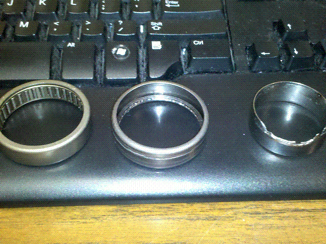

Hopefully this helps clarify a bit. I appreciate the response. RIng on left is new bearing, center and right are what I removed.

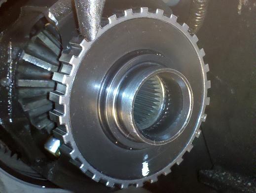

olchap
Posts: 137
From: Elizabeth City, NC, USA
Registered: Feb 2010
Report this Post03-08-2011 04:37 PM Click Here to See the Profile for olchapSend a Private Message to olchapDirect Link to This Post

Report this Post03-08-2011 05:57 PM Click Here to See the Profile for olchapSend a Private Message to olchapDirect Link to This Post
olchap
137 posts
Member since Feb 2010
1fatcat. I think you might be on to something. Does anyone have a different part number for the bearing? I used HK4012, but perhaps that was wrong in the first place.
1fatcat
Posts: 1519
From: Zimmerman, Mn
Registered: Dec 2010
Report this Post03-08-2011 08:54 PM Click Here to See the Profile for 1fatcatSend a Private Message to 1fatcatDirect Link to This Post
Looking at that differential, I would say that was a "speedy sleeve" that was installed long ago to repair the damaged bearing surface of your differential. You probably have the right bearing, but a damaged differential, so you need a new diff. You should make sure the diff cover isn't damaged from the spun bearing too.
Edit: Does the thin sleeve fit nicely into the new bearing? If so, it's a speedy sleeve.

black88fiero
Posts: 402
From: Brunswick, Ohio
Registered: Jul 2006
Report this Post03-09-2011 02:13 AM Click Here to See the Profile for black88fieroSend a Private Message to black88fieroDirect Link to This Post
ya that diff is hurt...non hd's dont have a bearing they have copper/brass/bronze (one of them they are gold) bushing no needle bearings in them.. i would get a diff and a new diff cover.
olchap
Posts: 137
Report this Post03-09-2011 03:12 PM Click Here to See the Profile for olchapSend a Private Message to olchapDirect Link to This Post
Thanks again to everyone for your inputs. I spoke with Morad and have ordered another differential. They say that the sleeve is pressed on at the factory and practically never fails. I guess I was just lucky enought to be the exception to the rule.
1fatcat
Posts: 1519
From: Zimmerman, Mn
Report this Post03-09-2011 06:25 PM Click Here to See the Profile for 1fatcatSend a Private Message to 1fatcatDirect Link to This Post
That makes perfect sence. After thinking about it, a speedy sleeve would need the diff machined down slightly to work. So, it's not a speedy sleeve.
