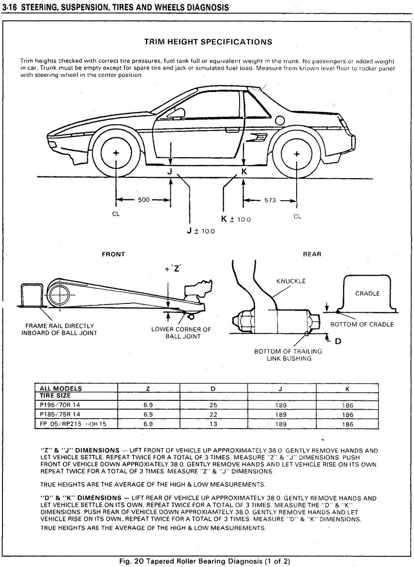

I could not find it in the 88 service manual but this may add something.

Well, I found the answer by drawing the wheels with their known tire sizes, wheel widths and offsets and sticking them onto my electronic drawings of the rear suspension. The answer just fell into my lap. For the '88's the rear wheel track is indeed approx 60.4" or more precisely 1538 mm (60.5") with P215/60R 15 on 15" x 7" (ET 30) wheels. I haven't calculated the front track but I'm guessing Road and Track was correct at 59.7"
Edit: Thanks ccfiero. I already had that drawing and although it didn't help for determining the track, it did help determine the rolling diameter of the tires.
