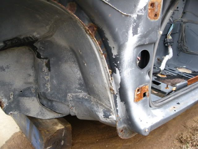

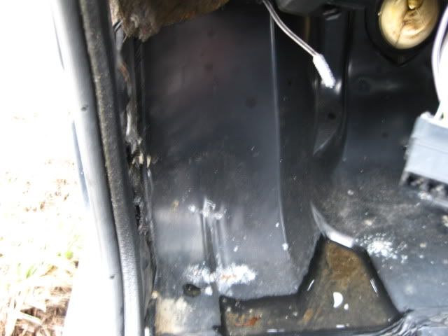

The foot rest is part of the spaceframe.
Outside:
Inside:
Only way to make it significantly smaller is to cut the panel and move it closer to the tire.
