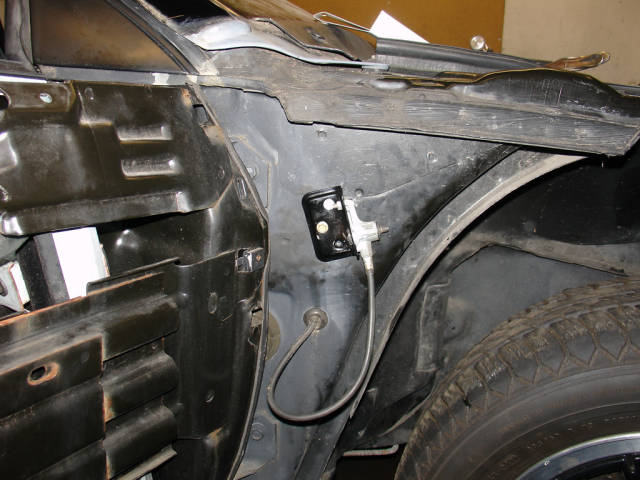

You can do what Fiero1Fan did and install it in the fender:

I removed my antenna and pushed it up into the A-piller. Fits perfect and signal is great. I filled the hole in the fender and all is well. Highly recommended.

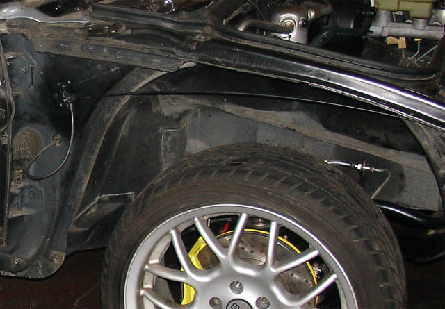

The A-piller is the vertical (well sort of) column between the door glass and windshield. It supports the roof. There are 2 A-pillers (fordward) and 2 B-pillers (rear) that hold the roof. SUV's and vans even have a C-piller because their roofs are so big.
When you pull the fender back you will see a small empty space in the center of the A-piller. Antenna goes in that empty space. It is tight fit and does not rattle. I get the same radio reception that I did with the antenna in the traditional spot.

The space in the center of the A-piller is accessible from below once you pull the top of the fender back.

There's a picture earlier in this thread showing the antenna laid down over the tire. If you look to the left you will see the A-piller, just push the antenna up into that empty space in the frame and reconnect the antenna base. So easy even a caveman can do it.
I did this on my car as well. It does affect my signal greatley but its a good looking mod for the car. it was also done on my formula which i now have no AM/FM in. Another option would be to run an aftermarket antenna to your back window. it deletes the antenna and you still have a very strong signal. I also rear a writeup somewhere about someone hooking there antenna into there rear window defroster and it seemed to work very well but you do lose the defroster.

That's why I recommend moving the antenna to the A-piller, you still get good radio reception and a shaved antenna. Best of both worlds.

Report this Post03-17-2011 06:57 PM Click Here to See the Profile for tox1cchickenSend a Private Message to tox1cchickenDirect Link to This Post
I just wen and did this today, I had to go with the over the wheel method, because the antenna kept getting stuck when I tried to put it in the pillar... it works great though.
