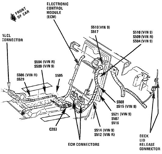

The coolant temperature sensor used by the ECM looks like this
