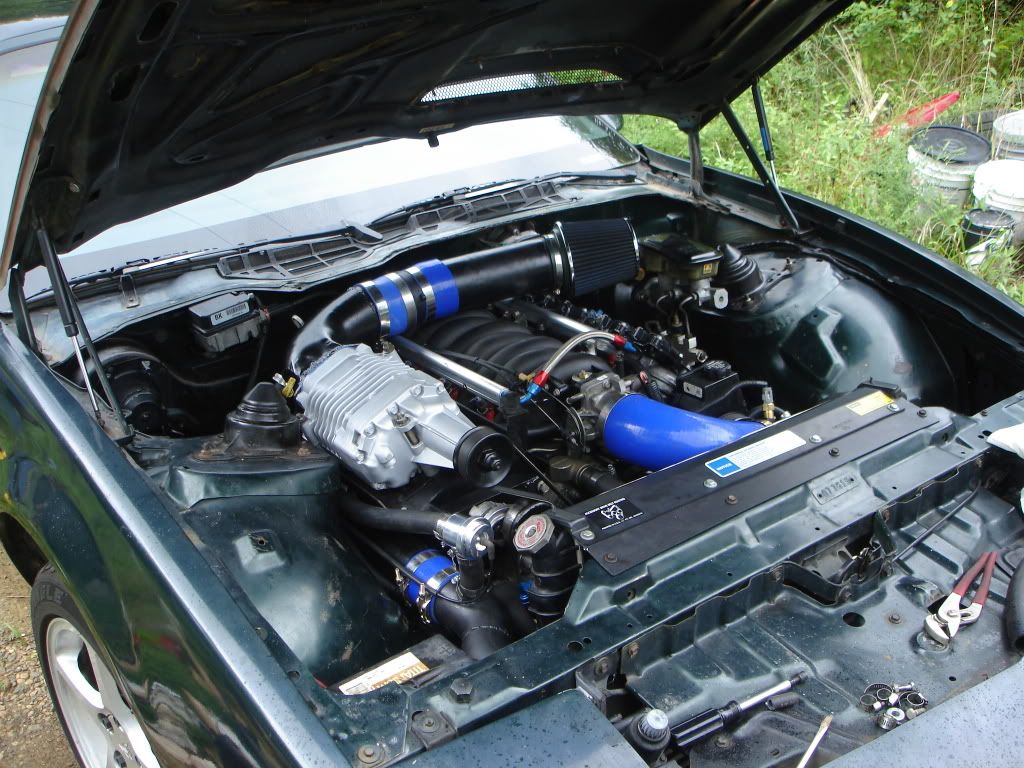

This is me, helping to replace a bad set of heads on an LS:
The M90 was used because there was an extra laying around. The engine dyno'd an addition 60 hp. It has since been replaced with an M122

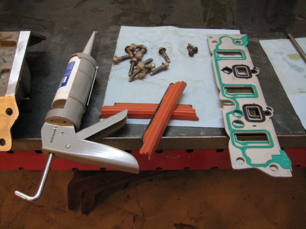

You can tell by looking at it. You can only see the edge of the gasket, but look at it and see if it's black plastic or silver aluminum. You might want to use a q-tip to rub any dirt off first. It's where the intake meets the head.
I don't have any pics of the plastic ones, but these are the aluminums.

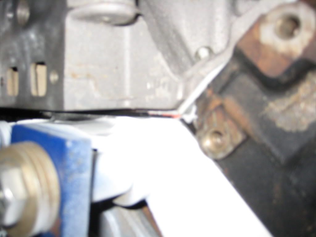

Here's a great picture where you can see what to look for below the supercharger lower intake (wish I had taken more pictures).
A specific culprit for the plastic gasket failure was Dexcool coolant. DO NOT use dexcool in anything (tractors, 3800's, LS's, 2.5L's), Dexcool is garbage, and Its beyond me how they haven't had so many class action lawsuits they abandon the formula completely.

Pocket's car is awesome! I can't wait to see the M122 dyno numbers!

what car is that? i cant figure it out.
dhobbs84sc
Posts: 407
From: Connersville, Indiana
Registered: Jun 2009
Report this Post03-19-2011 04:13 PM Click Here to See the Profile for dhobbs84scSend a Private Message to dhobbs84scDirect Link to This Post
I'guessing ta? Pop up headlights
donnie072003
Posts: 1956
From: LaSalle, IL.
Registered: Feb 2010
Report this Post03-19-2011 04:27 PM Click Here to See the Profile for donnie072003Click Here to visit donnie072003's HomePageSend a Private Message to donnie072003Direct Link to This Post
Thats my guess too!
