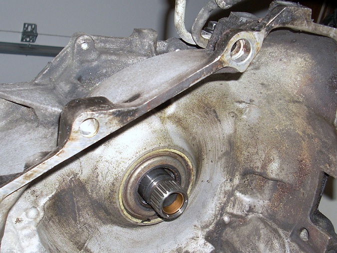

i wasnt aware of a difference beside one has the hd diff and the other doesn't.
i have a 4t65e from a 2002 impala and i also have an ls4 out of a 2006 impala. dave at triple edge performance just told me that it wouldnt work
so what else is different besides the internals, as i was going for a full rebuild
I did notice the starter location was at the bottom

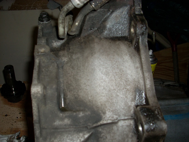

darn, so i should have gone with the f40.
would it be possible to relocate the starter like with the f40.
could put the starter here??
of course i did only spend 200 on the trans, so im not out that much hell i could probably turn a profit selling it. as soon as i put it back together
