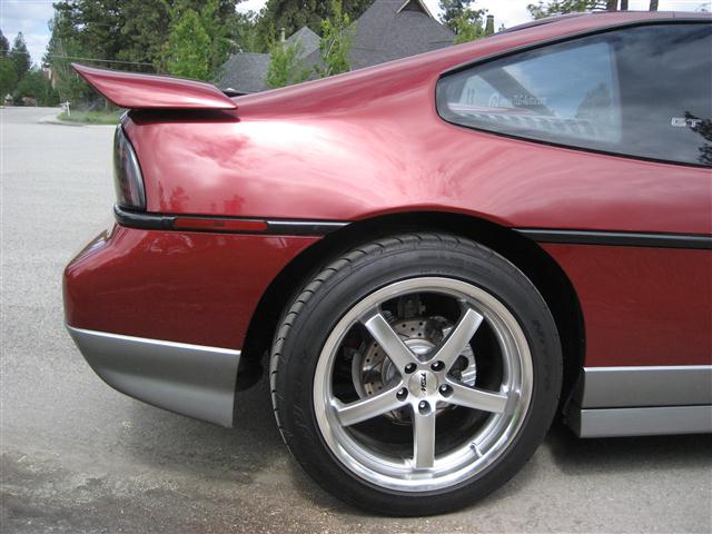

Hi does any one have any pics of drilled and slotted brake rotors installed ?
I have a set but they had no left or right side sticker on them, so not sure if ive got them on the correct way round?

no picture but i believe the slot should go out and back away from the direction of rotation. Almost like the speed of it spinning is bending it back and out.

I think thats the wrong orientation of the rotor, the slots should be "flowing" against the direction of rotation for best braking.

I would "think" the idea is for them to flow out so what little heat /air the slot actually moves, it would flow out away from the center mass....but ...., for street use....i wonder if it really matters one way or the other. After looking at those pictures again, I see he has them on both ways. If you are really concerned contact the manufacturer or where you got them and see what they say.
The use of the slotted/drilled rotor has been discussed several times on here (search) and some say they make braking so much better, others say the brakes are better because of new rotors and the D&S is merely for looks on the street AND some say the D&S actually decreases the strength of the rotor which I can see. I still like them and will be getting some when I do the Corvette brake upgrade.

Mine came with direction labels on them, same as corvette rotor shown above, so it is correct for the RIGHT (passenger's) side.
You can see the red label at the bottom of the rotor between the studs
No. You want the slots flowing away, or out and up. The slots are for trapped gasses, and they are basically spun out.
Edit: Having the slots flow into your braking system would possibly increase heat. Also, take it from me, if drilled and slotted rotors are used in a street only application, you are really losing braking force, Normal, or spirited street driving does not get any benefits from slotted and drilled rotors. Yes, they look cool, but you are actually removing surface area for the brakes to grab the rotors. Just letting us folks know.

yes, I would also assume the slots flowing outwards with rotation, to expell gas build-ups - which is the whole point of the slots

That is my car in the pic. I had bought the slotted and drilled rotors for performance reasons a long time ago. Knowing what I know now, if I were to go keep a stock brake package, I would not go with the slotted and drilled rotors. Very noisey. But, you have to admit, they look cool.
