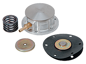

what are my options? ive only seen one on the WOT-Tech store. and some AN fittings to run SS lines to a universal aFPR on WOT-Tech as well. i do not want to go that direction.

thats about your only option, universal, or the WoT one...
sorry, ive been looking for a while now to find one, no luck.

What is the point of adjusting the fuel pressure on a modern, computer controlled car?

get more flow from the injectors you have, rather then upgrading the injectors, and finer tuning of the system with boost.

Get the Holley adjustable fuel regulator

Originally posted by hookdonspeed:
[Adjustable fuel pressure allows you to] get more flow from the injectors you have, rather then upgrading the injectors, and finer tuning of the system with boost.
I disagree. That's what I used to think until I actually did some flow vs. pressure experiments with the OEM Fiero 14.7 lb/hr injectors, and they appear to be a constant-flow-rate design. I measured very little difference in actual flow rate from 38 to 55 psi, which pretty much confirmed what my BLMs had been telling me as I varied fuel rail pressure.

Marvin is 100 % correctomundo ,, there is no need to ajust fuel pressure ,,any ajustment needed should be miniscule,, a good way to needlessly screw up is to start messing with fuel pressure ..
