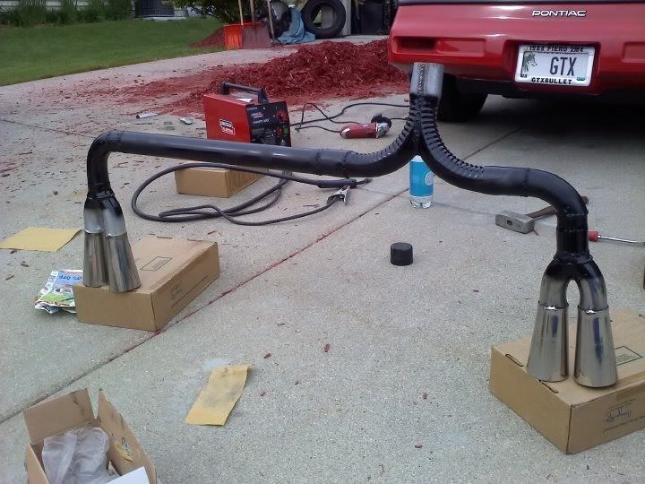

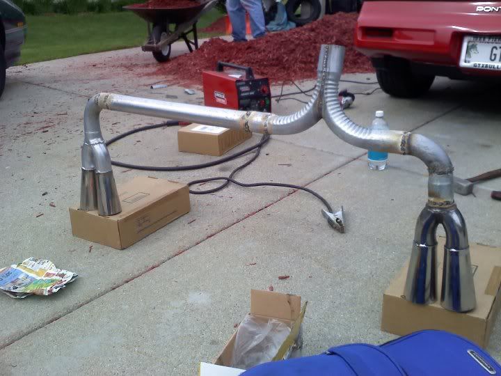

antuzzi I'm glad you asked this. I made a straight pipe freeflow muffler delete for my 88 Coupe.
here are some pictures
not including the brand new GM tips I scored last year for cheap I spent under $20 to make it.
I bought 2 90 degree 2" pipes, one 2" straight pipe from Orielly's (their's are longer than autozone).
I cut the 90 degree pipes from the centers of the narrow openings in a stright line till they split. I welded the 2 together VUELA!!! home made y pipe.
it has absulutely no raspiness to i at all. it actually acts as a toner/resonator. right now I have a catalytic convertor and that pipe on my Iron Duke 88 Coupe, it's great!!
next up will be to do my 87 GT Fastback 5-speed I just got. then remove the cat and put a glasspack in place.
if you wat help of for me to make you one I'd be more than will to help you figure it out or answer questions.

Any chance you could post a sound clip and dimensions?

any chance you could post or send me some dimenssss-i-o-ns on that beautifull contraption you have fashioned there
