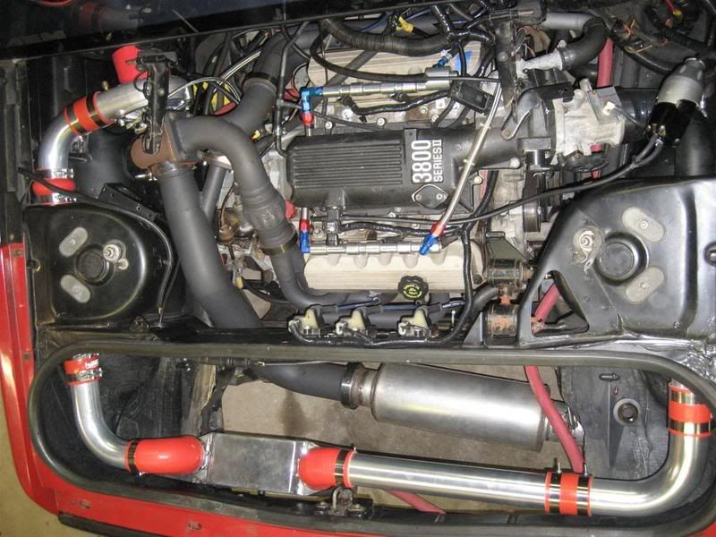

I have built up the engine and put it back in. I went with the ARP studs and the severe duty gasket from felpro.
I also redid the intercooler arrangement.
http://img51.imageshack.us/i/img2740b.jpg/
http://img688.imageshack.us/i/img2739s.jpg/

Report this Post03-14-2010 12:56 PM Click Here to See the Profile for blkpearlClick Here to visit blkpearl's HomePageSend a Private Message to blkpearlDirect Link to This Post
Thanks for the pics Boretti. The setup looks great, and gives me a good idea of where exactly the Turbo could go. Looks like the EGR was removed?

Report this Post03-14-2010 01:46 PM Click Here to See the Profile for borettiClick Here to visit boretti's HomePageSend a Private Message to borettiDirect Link to This Post
Thanks. The EGR is gone yes. I would recommend to do that. Its going to be mostly trouble if you keep it.

Wow, and people say that I have a lot of piping!!
boretti
Posts: 40
From: Oslo Norway. and Orlando USA
Registered: Oct 2009
Report this Post03-16-2010 01:26 AM Click Here to See the Profile for borettiClick Here to visit boretti's HomePageSend a Private Message to borettiDirect Link to This Post
Hehe, its a lot. Do you have pictures of how you did it?
Jncomutt
Posts: 8916
From: Charlotte, NC
Total ratings: 221
Report this Post03-16-2010 12:26 PM Click Here to See the Profile for JncomuttSend a Private Message to JncomuttDirect Link to This Post
I'm using a 3.8L engine and an intake manifold from a camaro. IDK if its even possible for you to use the camaro 2.8 intake on the fiero 2.8. If it would work, it would put the TB on the pass side. Here is a picture anyway.
Its an older pic, but you get the idea.
Click Here
