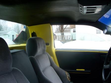

mine is a non sunroof and I did mine in black vinyl
this is the best pict. i have it holds up fine Ray
