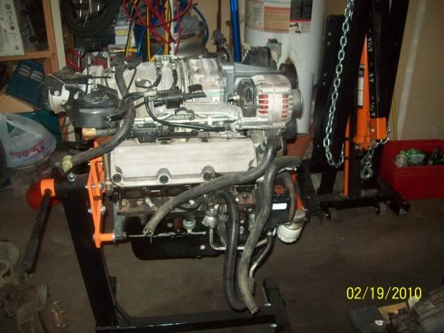

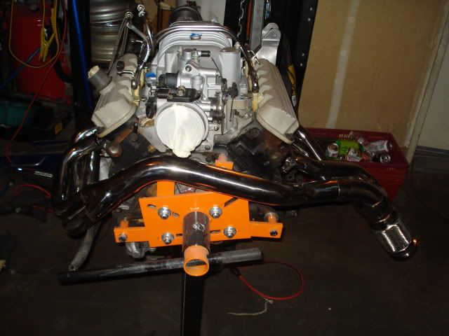

I used the top 2 & the furthest out on each side, I used spacers (wrenches...) on the non dowel openings to keep it even.
http://img.photobucket.com/...i/Fiero/a12d460f.jpg
http://img.photobucket.com/.../Fiero2/8bd5f14d.jpg
http://img.photobucket.com/.../Fiero2/dea3ed91.jpg
http://img.photobucket.com/...i/Fiero/d42d9c02.jpg
Ghetto but it worked, the wrenches were the exact same width as the dowels.

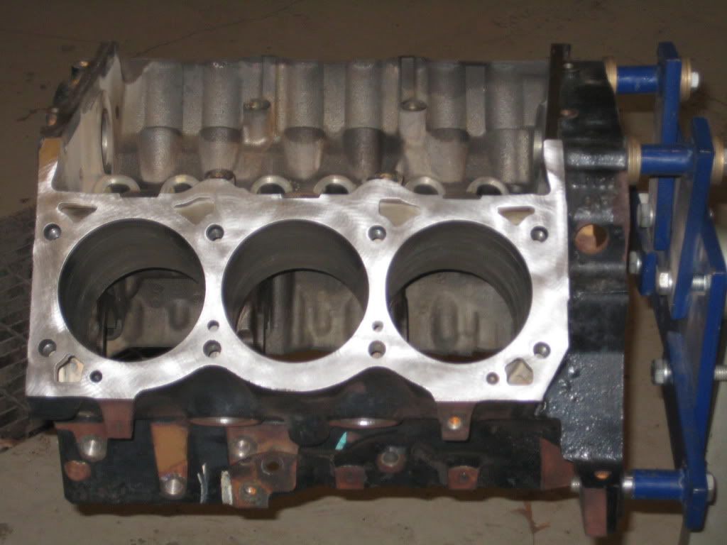

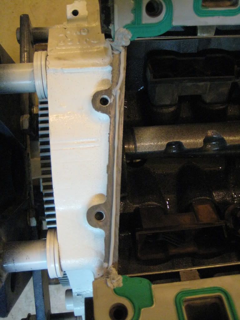

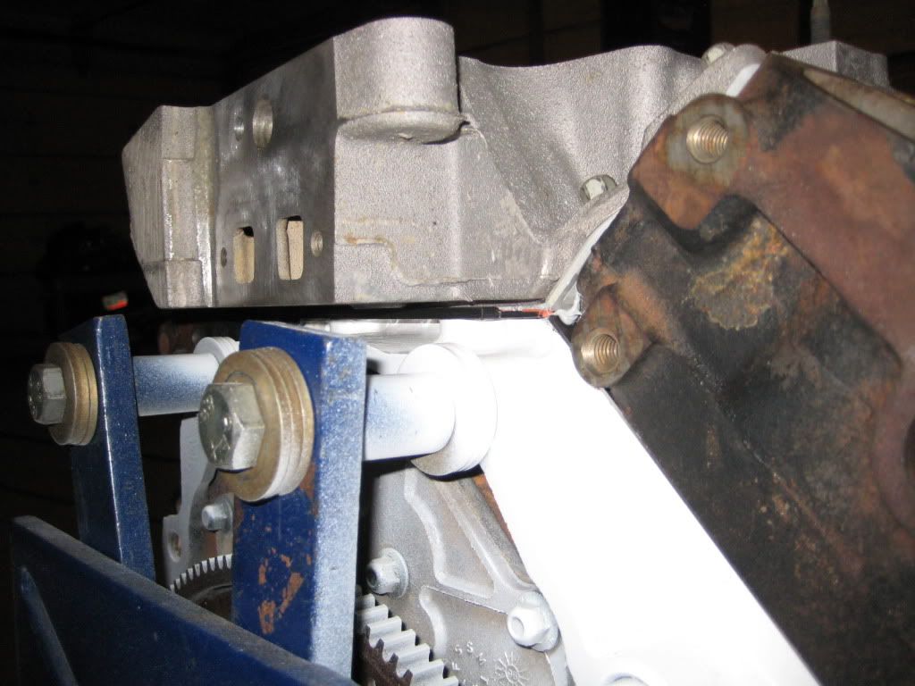

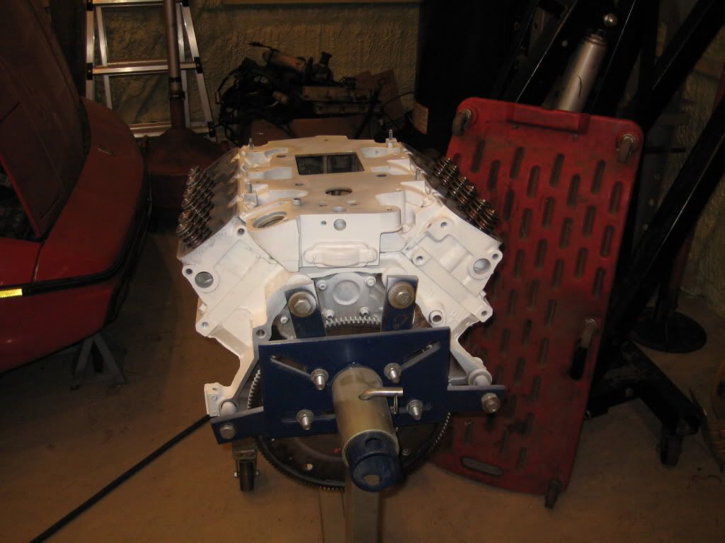

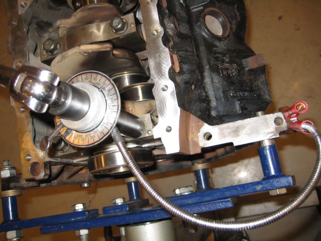

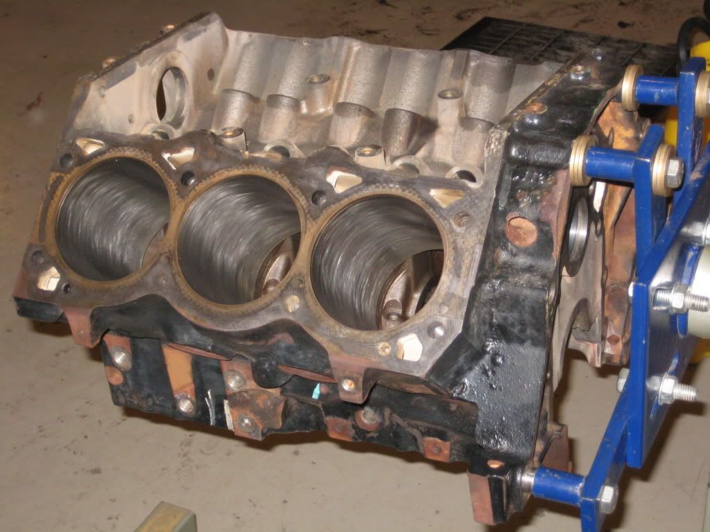

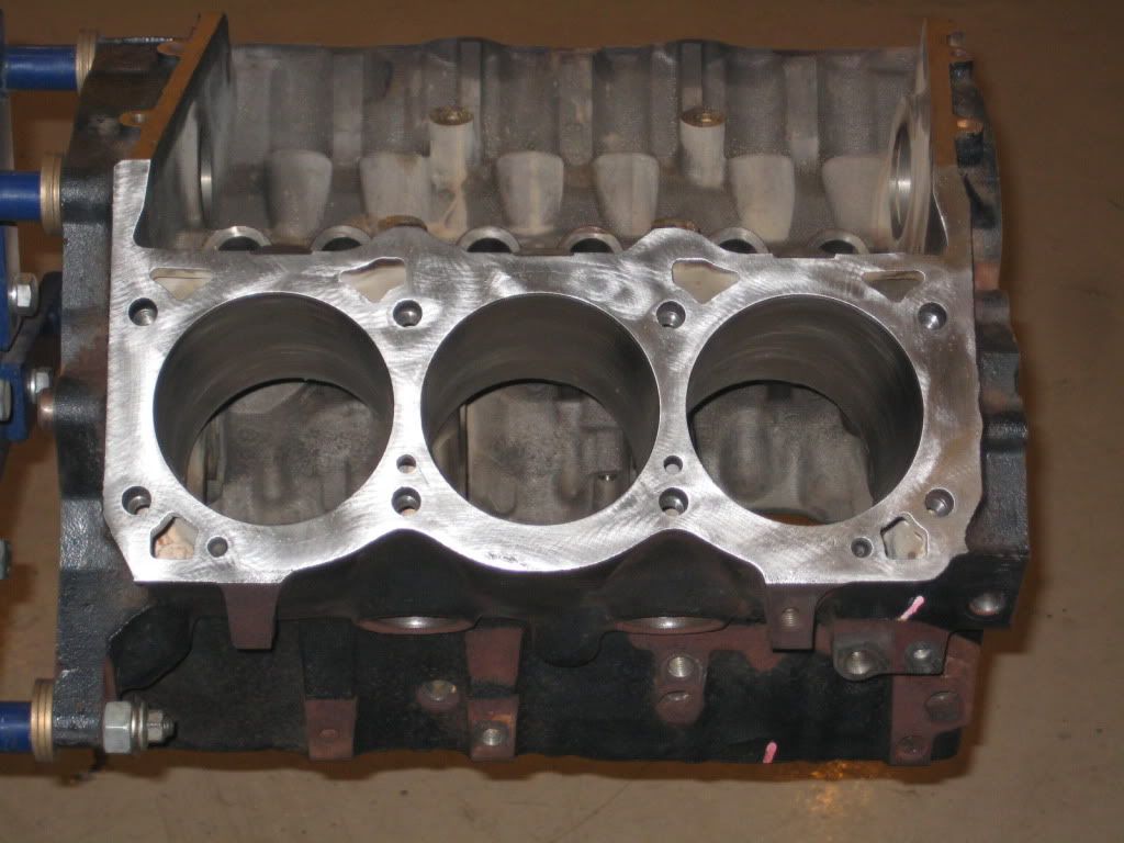

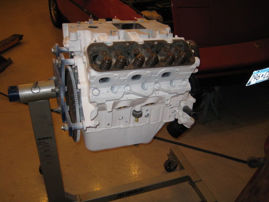

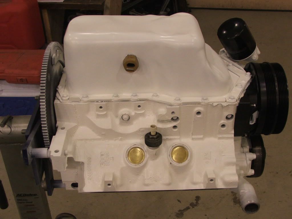

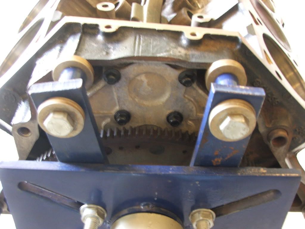

I also use the two top and the two sides, then I add large washers behind the non dowel holes to space it out even with the pinned hole. Use the correct size bolts, I forgot if bell housing bolts work for 3 of them? Then a long skinnier bolt w/nut for 1 of them. You may need some good washers too, grade 8 washers are thick and don't deform easily like the cheap thin washers do. Some people lift the engine up and bolt the fixture on in the stand and all, I like to bolt the fixture to the engine on the ground, then lift the engine and fixture into the stand. Either way works though. Here are some of the pics I took of my build that shows the engine mounting to stand.

what year is that engine? I was expecting a cast aluminum oil pan...
1fatcat
Posts: 1519
From: Zimmerman, Mn
Registered: Dec 2010
Report this Post01-07-2011 10:55 PM Click Here to See the Profile for 1fatcatSend a Private Message to 1fatcatDirect Link to This Post
Mine is a 99, series II, L67
