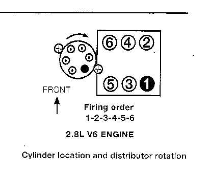

86 gt fastback 2.8 4 speed Hey everyone I got a big problem now. Went outside today to put new ignition wires on and I think I got it all crossed wired or at least one wire is I think. I did it by the firing order 123456 going in a clockwise motion and now all the sudden the car wants to jerk hesitate just really sluggish and takes for ever to catch up speed. I also noticed that when I let up off the clutch slowly go where it starts to catch the tac is jumping back in forth anyone know what could of happened computer service light also flashes code 33 and 44.

This thread might help you figure out whether you've got the wires mixed up on the distributor. Just remember that when you go to plug in the other end of the wires to the spark plugs, that number 1 cylinder is on the passenger side closest to rear of the car, #3 is the middle one closest to the rear and #5 is the rear one closest to the transmission. The bank closest to the cabin is the even bank with #2 closest to the passenger etc.
www.fiero.nl/forum/Forum2/HTML/102161.html

On my car when I first started doing no.1 wire was on the side with the fire wall also 3, and 5 are as well and 2,4,6 wires are on the back side running along where the cruise control is and everything else

In ur reply u sent me the pic shows one three and five wires running on side with the cruise control box and 2,4,6 running on the firewall side of the car

Hmmm... that reminds me... if someone has removed and replaced the distributor (not just the cap), then all bets are off unless they reinstalled it in the same orientation as it was done from the factory. The thing with the Fiero distributor is that it can be installed any number of ways which will throw off the orientation of the wires relative to the cap. You're probably going to have to rotate the engine by hand until the timing mark on the harmonic damper lines up with timing tab on the timing cover. Just be sure to use the widest groove on the damper as your reference point. Once you've done this, there's a 50/50 chance you're actually at #1 TDC on the firing stroke or #4 TDC on the firing stroke. So, to get a good idea which one it is, take off the distributor cap and see which post it was pointing to. If your wires are correct, then the rotor under the cap will be pointing either at the post for #4 or #1. If it's pointing at anything else, then you've definitely mixed up the wires. There's still no definitive way to tell whether you are at TDC #4 or #1 unless you have a compression gauge or take off one of the valve covers though, but there's a good chance that they're very close to where they should go, so maybe you can figure out which way you messed them up.
One thing for sure, the cylinder numbers are definitely the way I described them above... ie: 1,3, & 5 are closest to the cruise control solenoid with 1 being at the pulley end of the engine.

Hey very sorry for the mixing I found a firing order diagram on google that shows that the odd number cylinders are the ones closest to the cruise solenoid I'm gonna try hooking them up that way with the finger way with my bro to see If we can get it on the compressoin stroke like that and hook up the ignition wires to the plugs and try starting it. I was thinking it was like a small block chevy with the odds on the left of block and the evens on the right of the block But it is totally opposite on the 6 cyls

Just remember that you're looking at a FWD engine from the opposite side you normally do. That's what messed me up the first time I did it.
